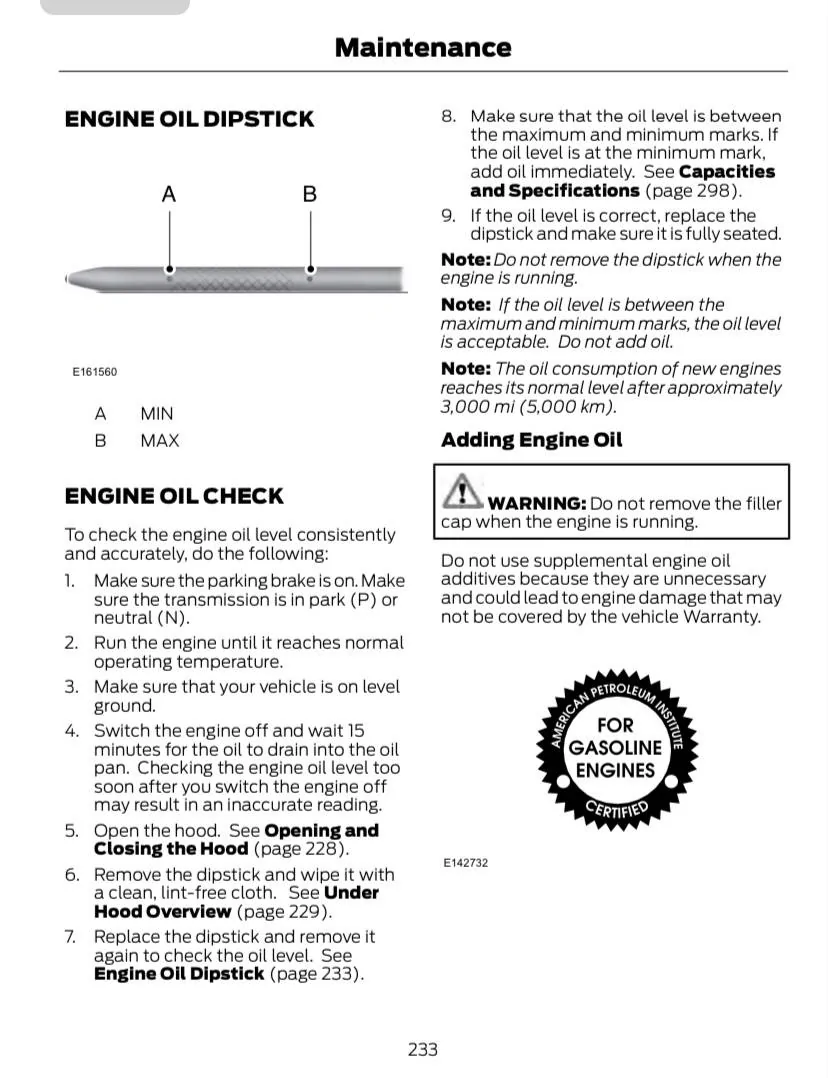

Underline is caused from the activation in the HTML box when replying to a message. Probably just activated it by accident.
Best way to check the dipstick:
Always check after engine gets to normal Op temps. Shut off vehicle, wait 15 mins for oil to drain back. Pull out once, wipe completely and then reinsert. Pull out 2nd time and try to view it with overhead garage light OR daylight, but looking at the dipstick at an angle.
The oil should be within the designated hashmarks based on your vehicle Powertrain and Owner’s Manual specifications.
Cobra Jet
Feb 12, 2015
771
17,595
20,037
Based on a 2019 GT, the owners manual states:
As long as the oil is between A and B, it’s “safe”.
If the oil is ABOVE B, the engine is overfilled and of course if BELOW A, well, you could end up with some major problems....

You.my issue I've got oil on both sides of stick at different kevels,one above the hattch and one in the hatch.ill post pic later.i read somewhere there's a technique to only get oil on one side,but can't find it.

I always have more oil on the underside of the stick when pulling it out. The one that shows oil to the bottom of the hash marks is probably correct in your case. (Educated guess with out watching you check it) FYI after an oil change with 10 quarts the oil level reads center of the marks, not all the way to the top so I'd say its safe to assume you probably lost/ burnt half a quart if your close to the bottom of the hash marks.
