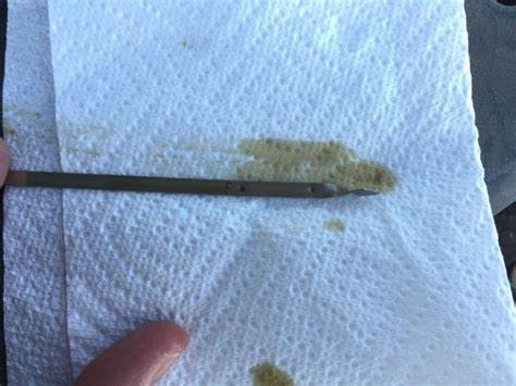

My method:
Drive the car till it gets to operating temperature. Make sure you are on a flat and level surface. Wait 15 mins to allow the oil to settle into the pan. Pull dipstick and wipe oil off once. Put the dipstick back in and pull it out to observe oil level with phone flashlight or garage light. If you are having trouble seeing the level, get a clean, white paper towel and carefully close it over the dipstick. DO NOT PULL THE DIPSTICK OUT. Open the paper towel and observe where the oil level is on the paper towel compared to the dipstick.
Here is a picture I pulled from google to give you an idea of what I'm trying to explain. Hope this helps.
