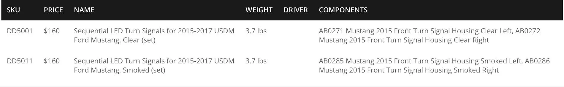

Just to confirm, the front Turn Signals on a 2020-21 GT500 are the same as found on a 2015-2017 GT?
I want to make sure I got the right Diode Dynamics front turn signal replacements. PN DD5011. They are shown to fit a 2018-2020 GT350, but the description says 2015-2017 GT, application shows 2015-2017 GT & 2018-2020 GT350. I know the bumper bracket must be modified to fit the GT500.

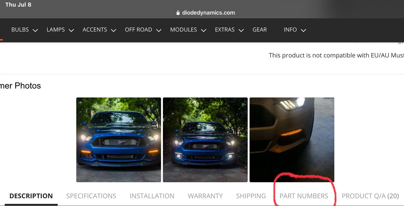

They may fit but that doesn’t mean they will work. I’m guessing that DD does not list them for use with the GT500 for a reason. Contact them before ordering.

I obviously didn't scroll down...:)
