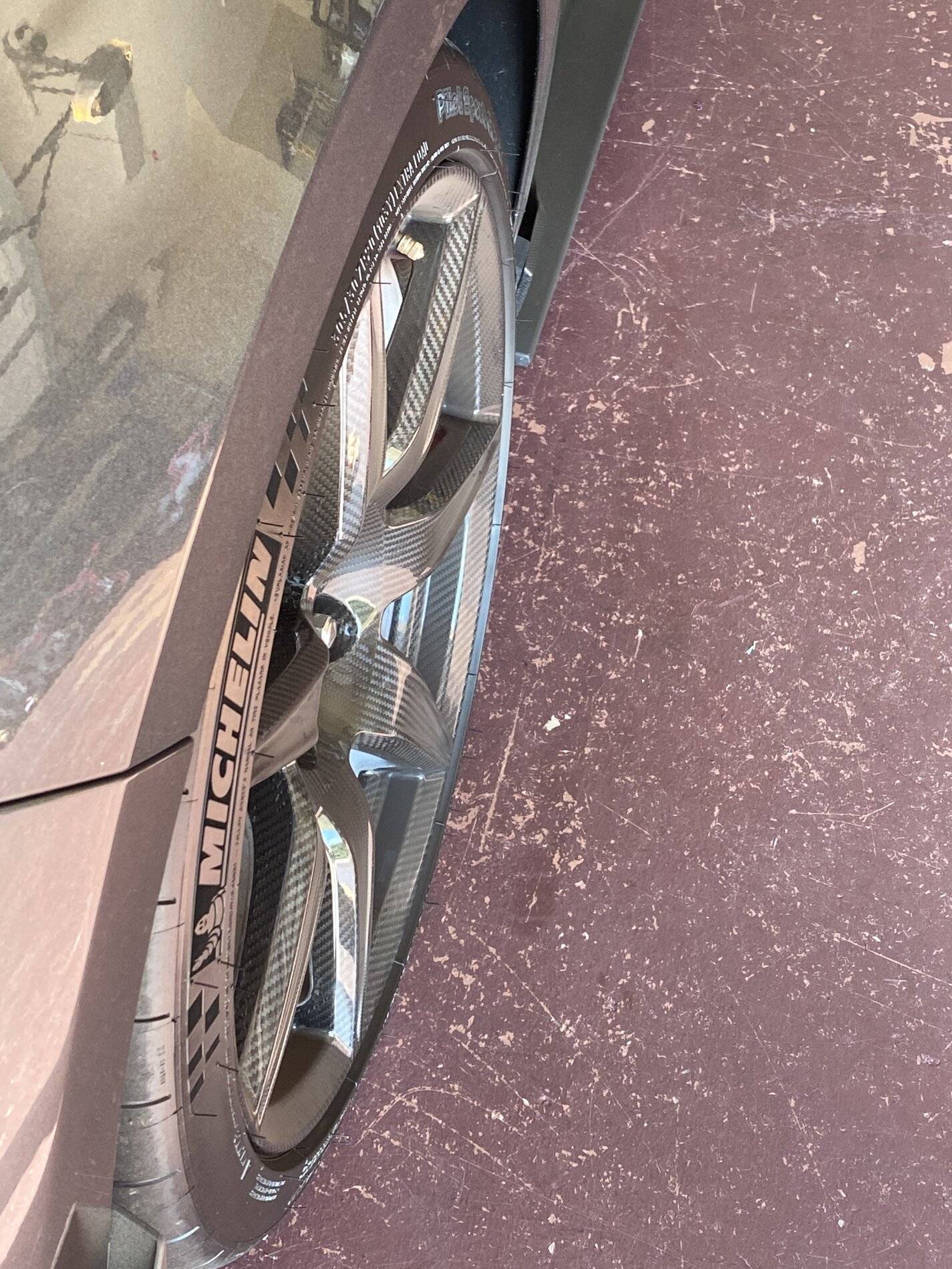

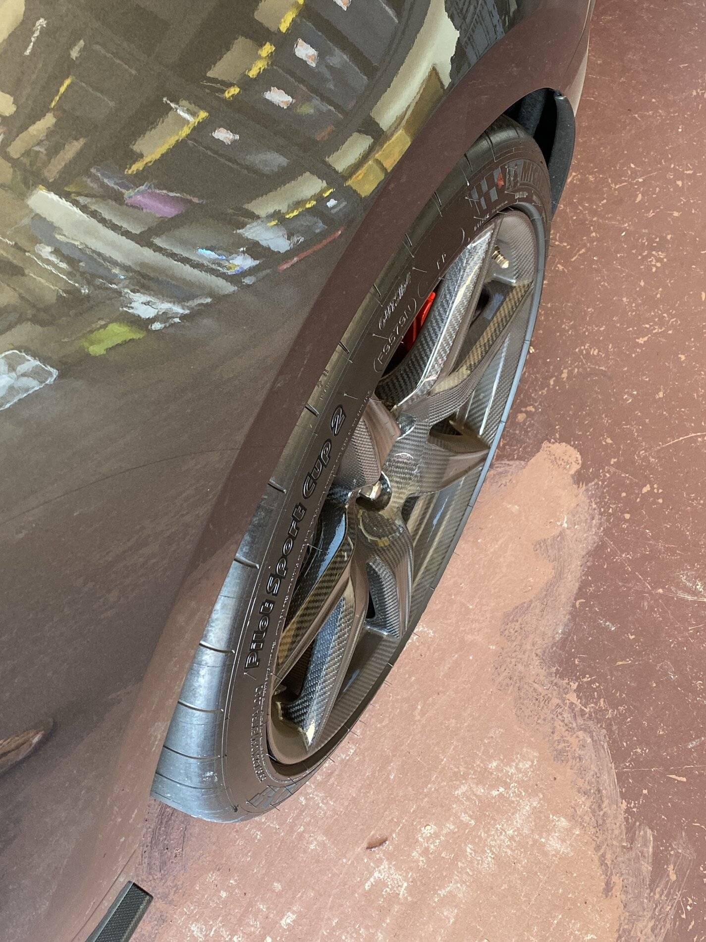

It seems like the front wheels are inset a little relative to the front fenders as compared to the back wheels which stick out a little more. Has anybody else noticed this? I wonder why they did it this way. ? Pushing those front wheels out just a little bit to line them up with the front fender curves would have looked pretty good in my opinion.

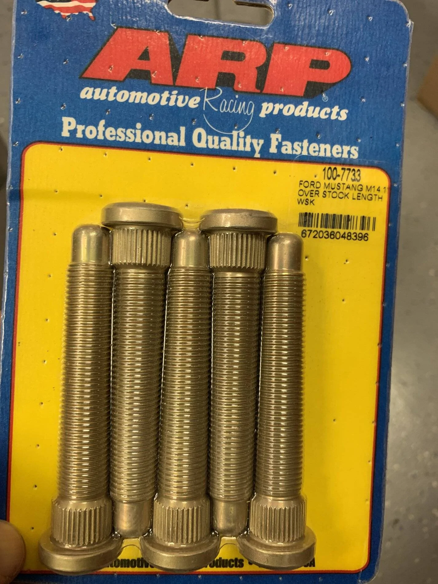

I do not, but I intend to find out. Although, my car has the ARP extended studs so my results will be different than both the base & CFTP cars.

All good questions. I have not heard of anyone measuring the stock CFTP studs, but they are longer than the base studs. I do not know the length, and I will not know the length of the ARP studs until I measure them. I "think" the ARP studs are longer the CFTP, but we won't know until we get measurements.

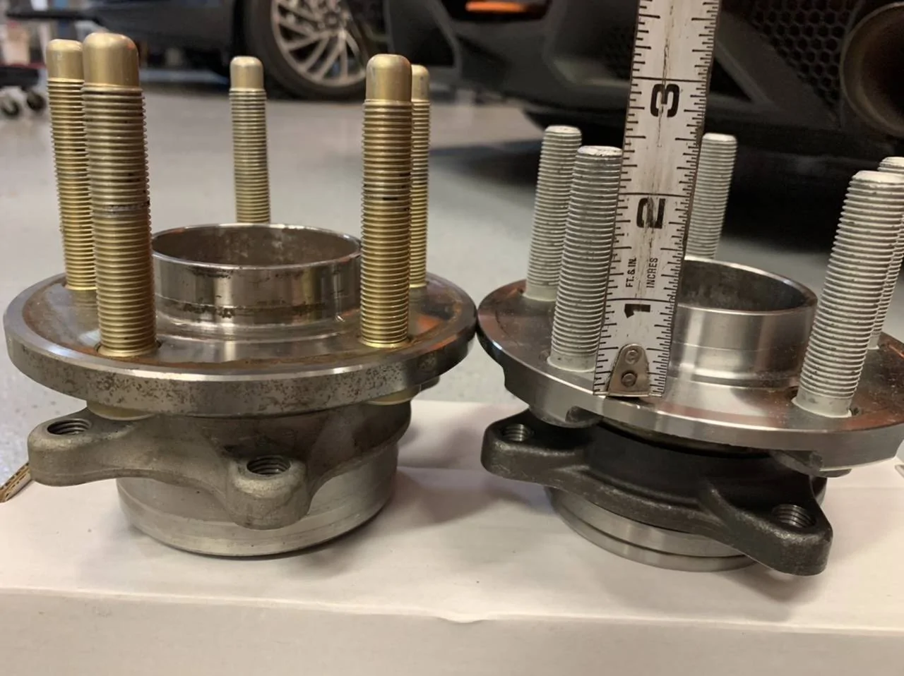

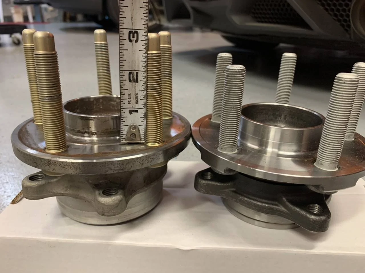

Here’s a pix of long ARP studs installed on a GT350 front hub and a stock GT500 CFTP front hub:
Looks like 2.5” and 2.375” threaded respectively without using my caliper.
I run a 5mm spacer on the front.
Thanks for that :thumbsup: I plan to use either a 5mm or 7mm.
