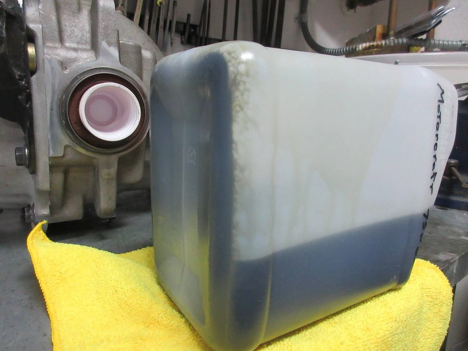

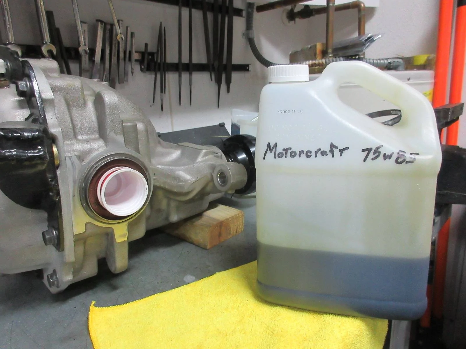

I did a gear swap in my GT350 at around 12,000 miles. I saved the factory fill OEM fluid in a clean gallon plastic jug. I believe this fluid stayed on the shelf about 6 months. (With plenty of time for contaminates to settle). Upon inspection I noticed some black residue had settled to the bottom of the jug.
Here in the second photo I turned the same jug on its side and you can see the residue stayed on the bottom.
The ford drain plugs have a magnet built into them and this black residue has seemed to accumulate on the magnet of the drain plug on every diff I have drained, (And I have drained a few). I call it the nasty black oxide that wears off of the ring gear and pinion. The black oxide finish on the gears I believe is from a process performed on the gears during manufacturing. Apparently Ford doesn't consider this as any problem.

I have been advising mustang owners to change the OEM diff fluid maybe at 5-10k miles, and I would definitely do it when the fluid is hot, to get all the residue out. If you have a traction-lok make sure you have the friction additive added back in, or make sure your fluid already has it.
For some additional info: I have removed my diff housing several times due to testing new gear ratios and newly designed rear covers so I have been able to inspect the fluid coming out every time. Also on the diffs that I have worked on such as bearing replacements, or new parts put in with polished ring & pinions, the fluid that I have drained out later is as clean as you could ever want.
