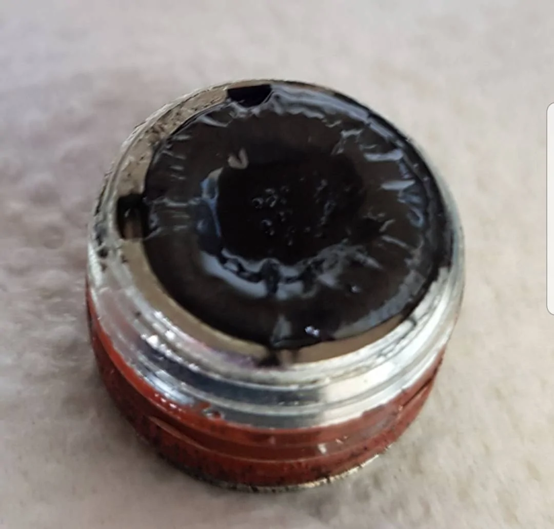

I removed the fill plug first, just in case I couldn't remove it after draining the fluid, preventing filling it up again. I took the drain plug out and let it drain for about 30min while I was cleaning the plugs. They have a magnet attached to them and were full of metal shavings so make sure to get them off before reinstalling.

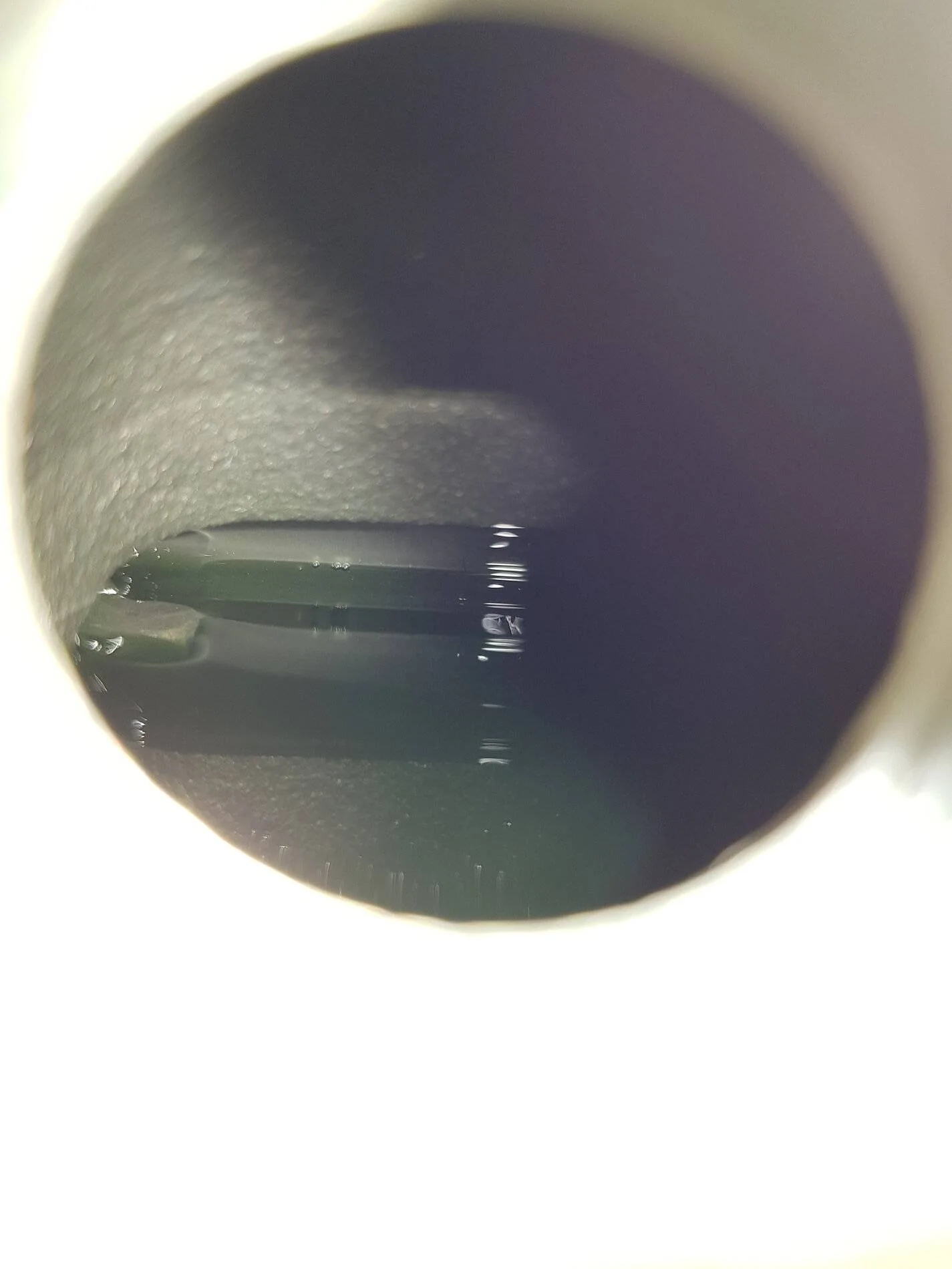

I filled the diff with Motul 300 LS 75w90 fluid. It already contains a friction modifier so no need to add extra. As mentioned above, I used 2 qts of oil and it never came dripping out the hole. I measured the fluid using my finger and it was at the top so it should be a little above 9mm. Front of the car was slightly higher so it should be closer to the 9mm mark when level.

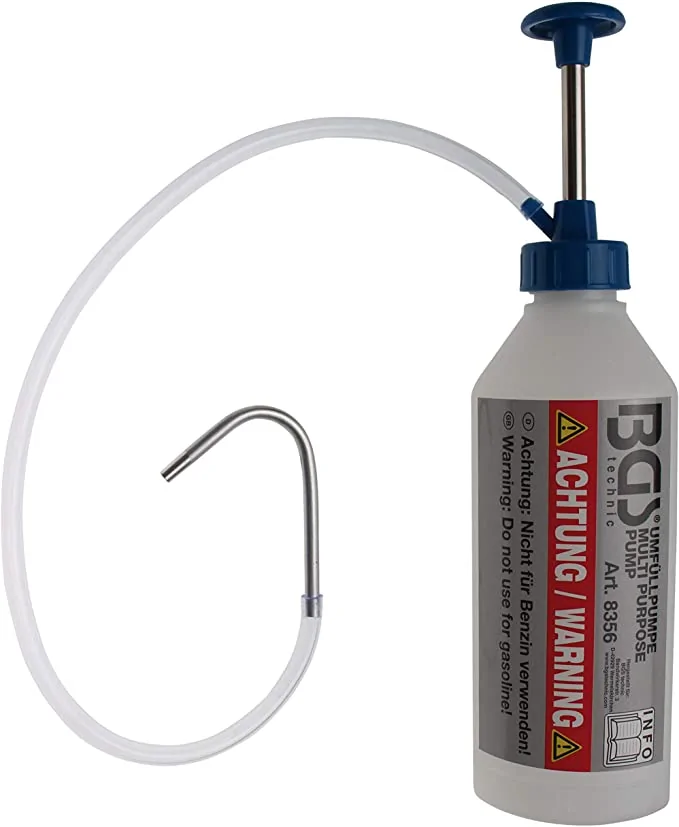

For filling I used a Multi purpose pump which was much easier than the syringe style pump. You will be working your shoulders off though since it did require a lot of pumps.

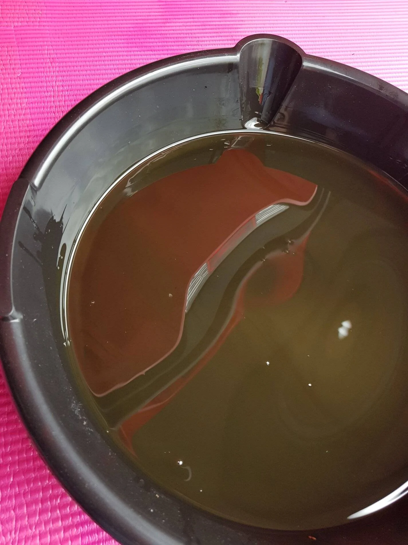

Overall very easy to do yourself, easier than changing the engine oil. I did mine because I've done quite a few track days and thought it would be good to get the metal shavings out. Fluid was very dark so might start doing it annually, depending on the amount of track days. Fluid was about 30$ so definitely worth the extra insurance.

This is how it looks when clean:

I basically did the same using a bend piece of cardboard paper. The carboard was wet at the tip when inserted into the fill hole. It's probably fine then, just found it odd that I had to use 2 qts of oil instead of the recommended amount.
