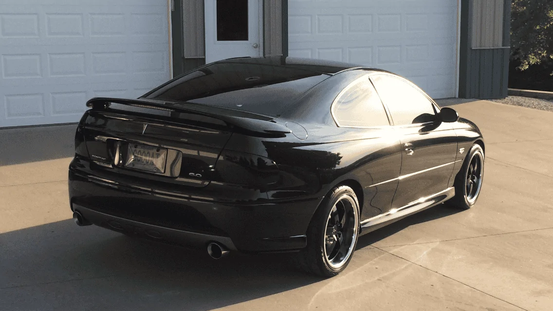

Damn, good thing you don’t have the 3.66 in the pre 18’s then. I can run 50 mph in first gear. That’s tall enough for me.
On the topic of gearing, I swapped 3.91’s for the stock 3.47’s in my GTO and it was a big improvement. I still rate the cam and tune as #1, but the gears weren’t far behind. Man, I still miss that car.
