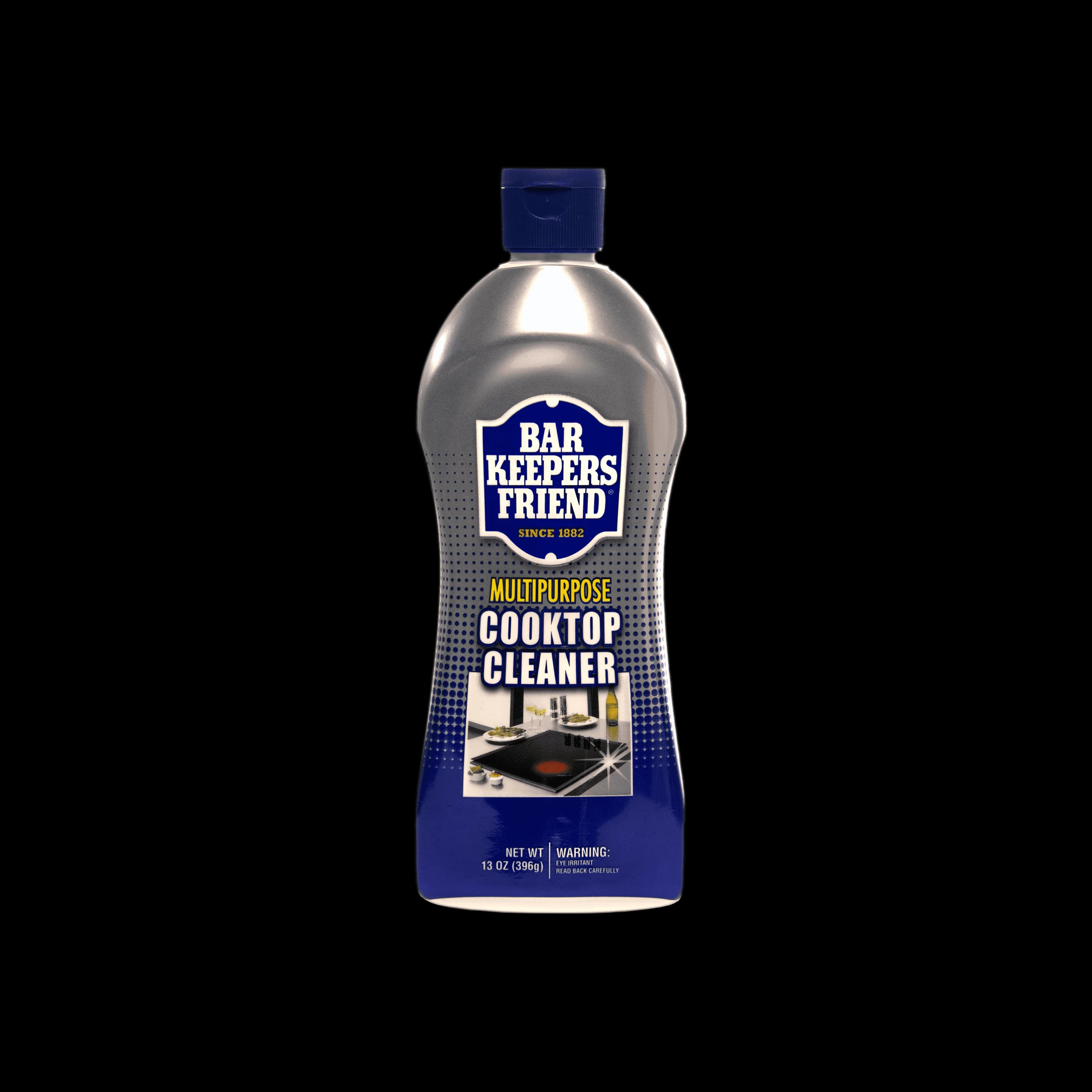

anyone saying invisible glass works with microfiber isn't talking about hard water spots/calcium deposits so ignore them.
this plus a buffing pad on a drill or buffer (doing it by hand doesn't work)
this is the simplest most effective way to remove water spots from glass.

Unless your skilled with buffing using a drill your likely to leave circular marks on the glass where you drill with pad if it's really bugging you have professional detailer come to your house and buff them out
Id try vinegar or invisible glass first
I've never had a stain not come out.but my water isn't hard

then you haven't dealt with actual hard water spots.
keep the glass wet and you can't damage it.

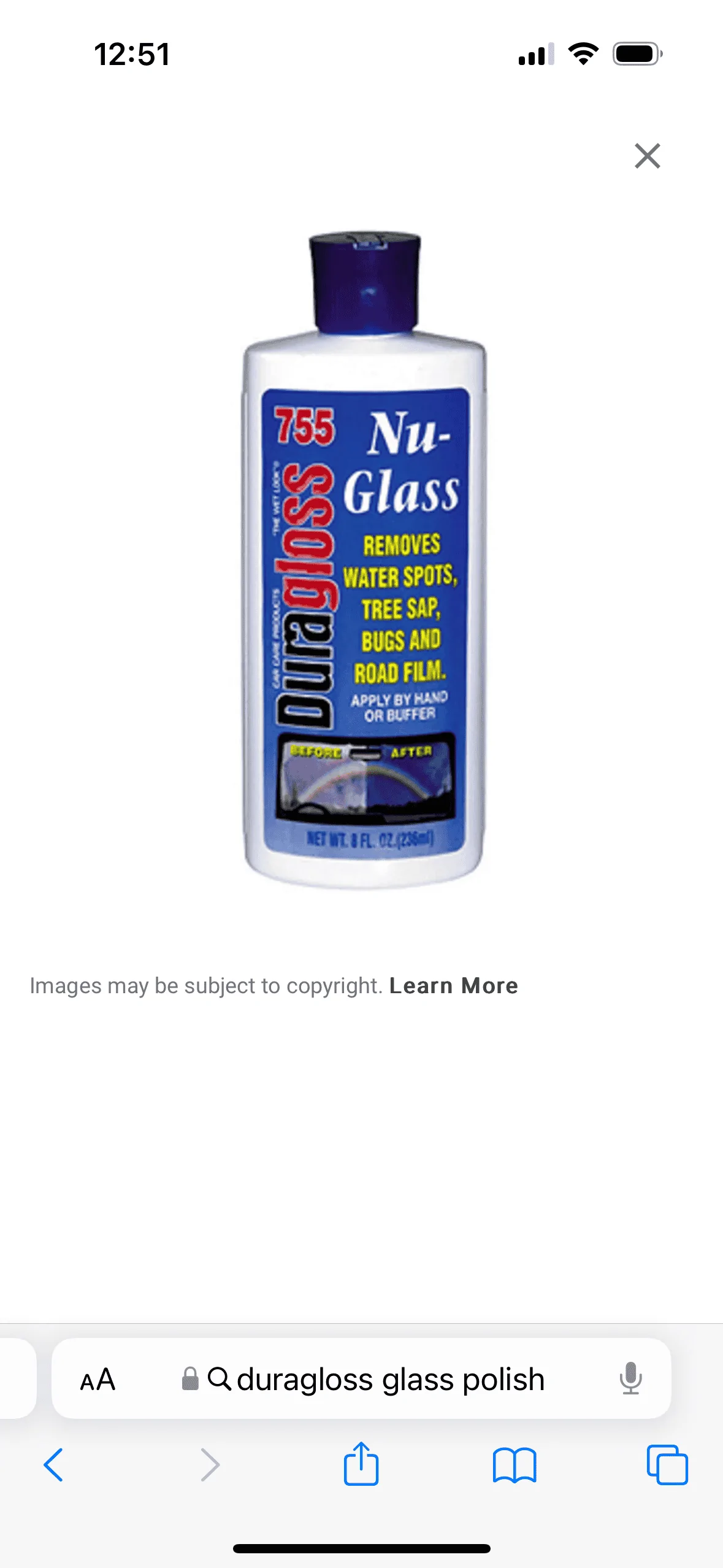

This is old school probably and I’m sure there’s better stuff out there now but I’ve used duragloss in the past and got some really nasty spots out with it I’ve always used it by hand never with a machine
