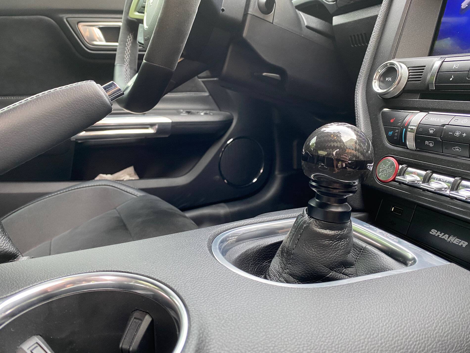

Got it all buttoned up. Really liking it so far. Haven't driven in complete anger yet, but positive impressions so far. I actually have confidence third gear will be there when accelerating hard, rather than hitting a brick wall. You really feel each gear and KNOW you're engaged. Everything is just less vague feeling and incredibly solid. Essentially zero movement in the shifter outside actual shifting motions.
Only negatives so far: push down to reverse takes considerable effort, same for getting over to fifth/sixth. But I'll get used to it and I'm sure it'll break in some.
The adapter for my factory knob fit great and looks really nice. I like the black compared to the factory silver color.
I have the standard height race spec shifter and it's MAYBE half an inch lower than stock. Perfect for me and what I was looking for.
