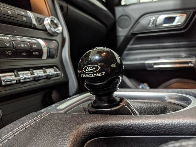

I really want to get an MGW but it is a mess trying to understand the variables that affect overall height of the shifter. You have Race and X spec, you have standard and low pro handle length, and then you have the “accessories” that determine overall height. You can get a standard or a low pro handle and still end up with the same overall length shifter. See video:
The mix of the rubber boot grommet, the collar, and the knob are where the magic happens outside of your Race vs X Spec choice. I see a selection for a stock collar to retain the factory look with the push down reverse on their site but no other low pro collar options. Does anyone know the magic combo to get the end result in the pic below? I want this height with a GT350 knob. My guess is that the GT350 knob would slightly increase overall height over the ball in the pic and I think that would be perfect for me. I appreciate anyone sharing their experience.
