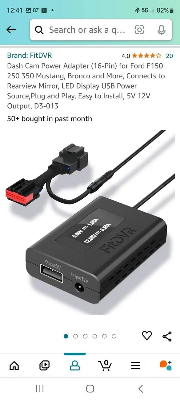

Since I have a convertible hardwireing to the fuse box is not something I wanted to tackle. So I used this device. It's super simple to connect but is a bit bulky. Still, I was able to conceal the device and wiring. Concealment would be much easier in a car with a headliner. The one drawback is it only provides switched power, no constant power for a parked mode.
My other cars are hardwired to the interior fuse panel. Fuse taps make it near fool proof.
