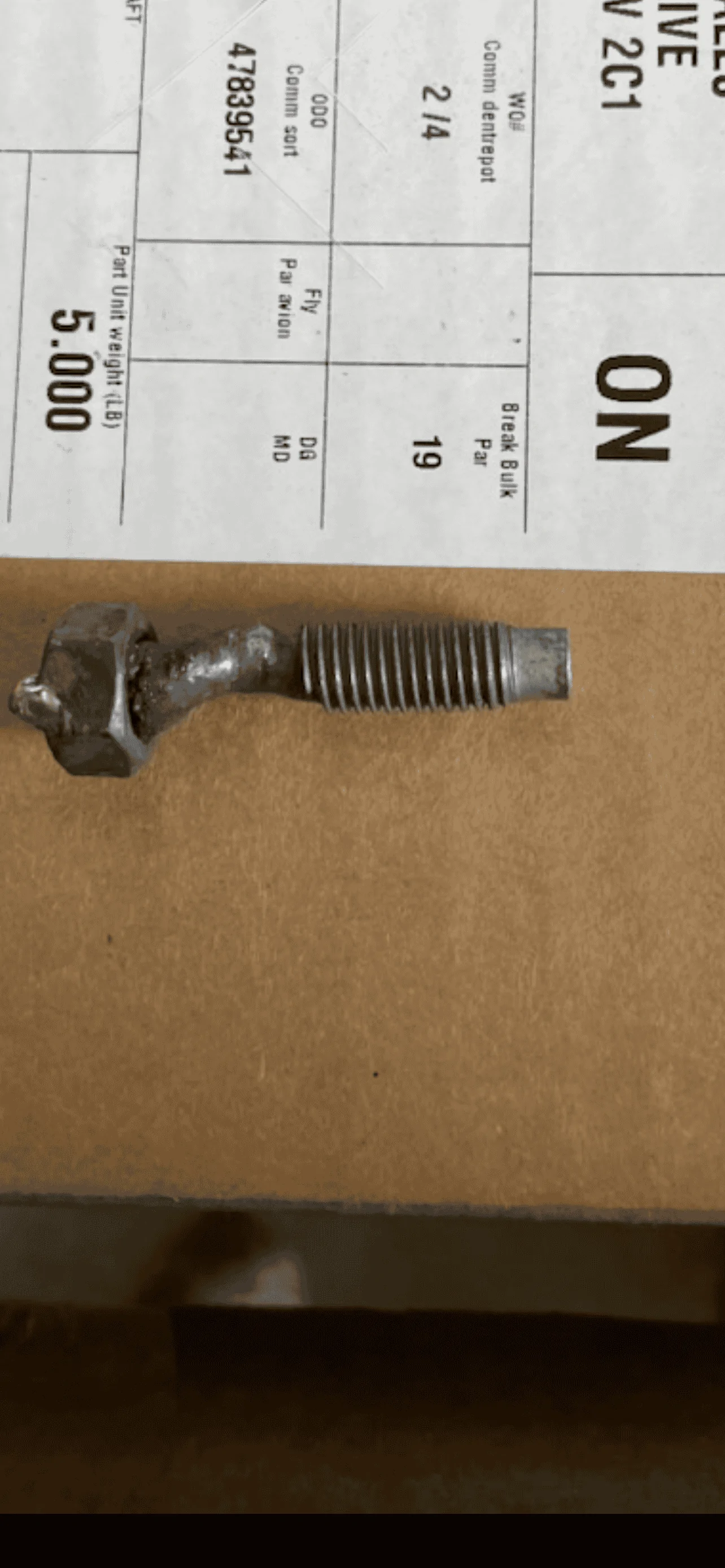

So what the dealer found was all of the bolts for the compressor were loose, one of them actually came out all the way and was contacting the steering rod and causing a lot of vibration to the steering above 2K RPM. Unfortunately one of the bolts did shear off and the tip of it is stuck in the block. The tech said there's a good chance he can take it out without damaging the threads of the block so fingers crossed I can get away with not having to use helix thread or whatever it's called. Will find out in the coming days if I get lucky.
Tech also said whoever replaced the unit may have not torqued it properly, very rare to see all bolts coming loose.

It took a week, the dealer had to call in some skilled tradesman to spot weld the bolt out. Luckily the Brocken bit came out without damaging the threads so the block is good!
Ready to hit the road again.
