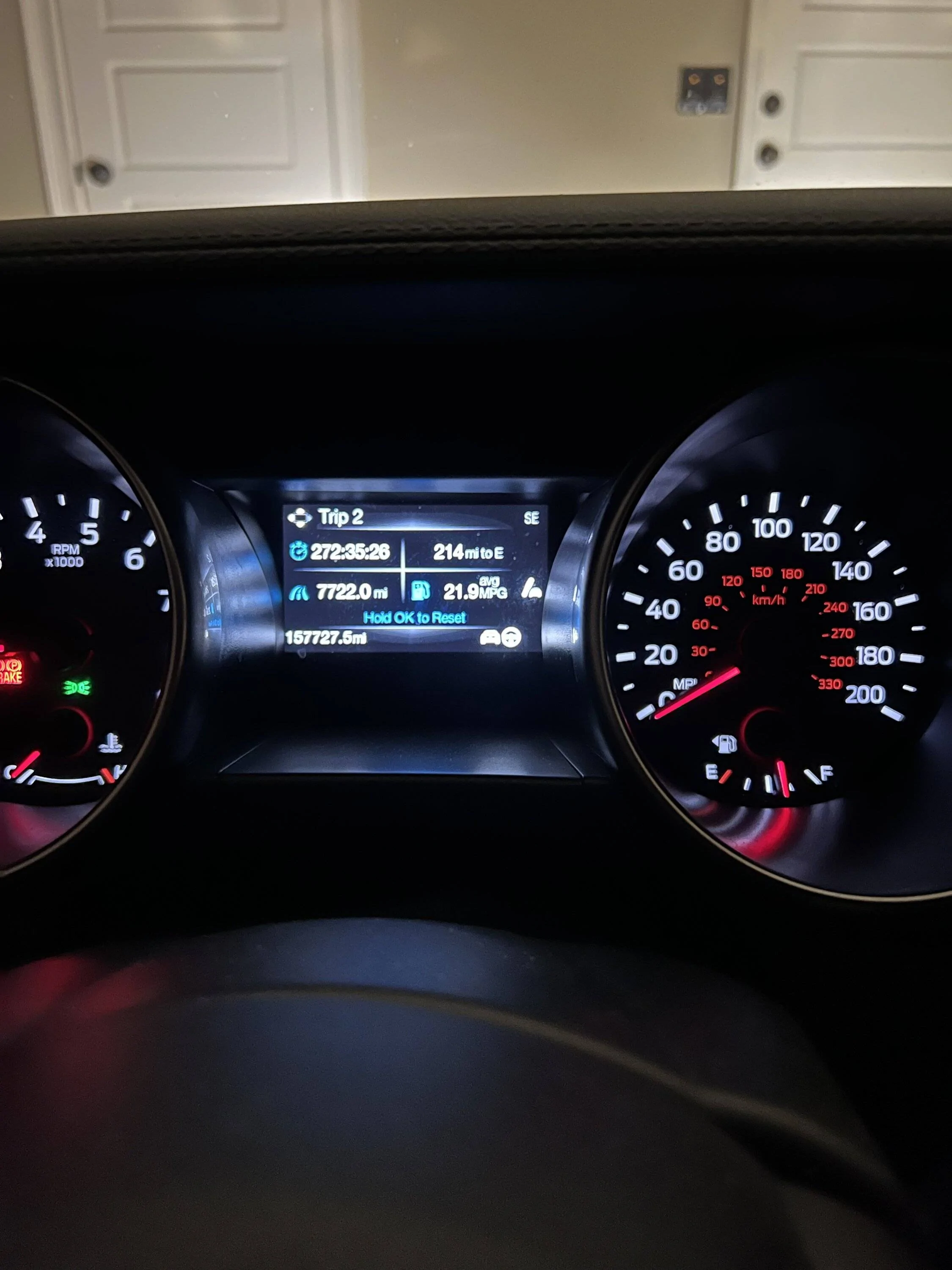

Update: Soon to cross 62k miles (mostly Whipple boosted) on my '17 Gen 1. Little to no oil burn until I reach approx 35% oil life remaining . Once it hits this mark I start to burn about a quart for the remainder of the oil life. Found the final oil breakdown mark, and now my new oil change interval. I've been running Motorcraft oil and filter from day 1.
FYI, I did swap to forged MMR OPG and sprocket gear very early on in its life.
