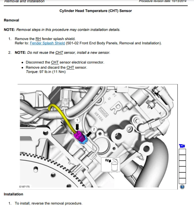

Do you happen to know the location of the CHT Sensor on 2015-2017 GT’s? Having a hard time finding info.

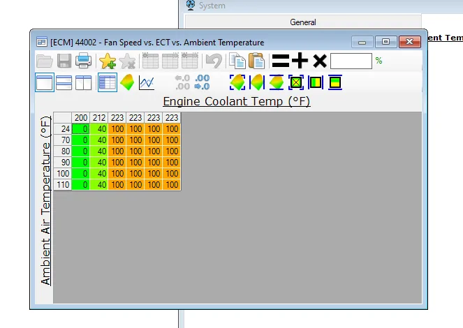

Makes sense. The target CHT for in the PCM is 212*, and the fans are just barely running at that temp. It's only around 223* that all the systems are in max cooling mode so that's probably why you top out at that point.
Explains why I bounce between like 225 and 215 most of the time. I assume that when A/C is on the fans are always running so it never really gets a chance to get hot.

Yes, fans are running and the shutters are wide open when the AC is on.

2017 GT here, temps have been in low 90s humidity 80% or higher. What temp do fans kick on when AC isn’t running?My CHTs were 215 & below, just want to make sure fans are working as advertised. The heat/humidity is brutal on the coyote!
Target engine temp is 212* and fans start to kick in around 212* but only at half speed.
