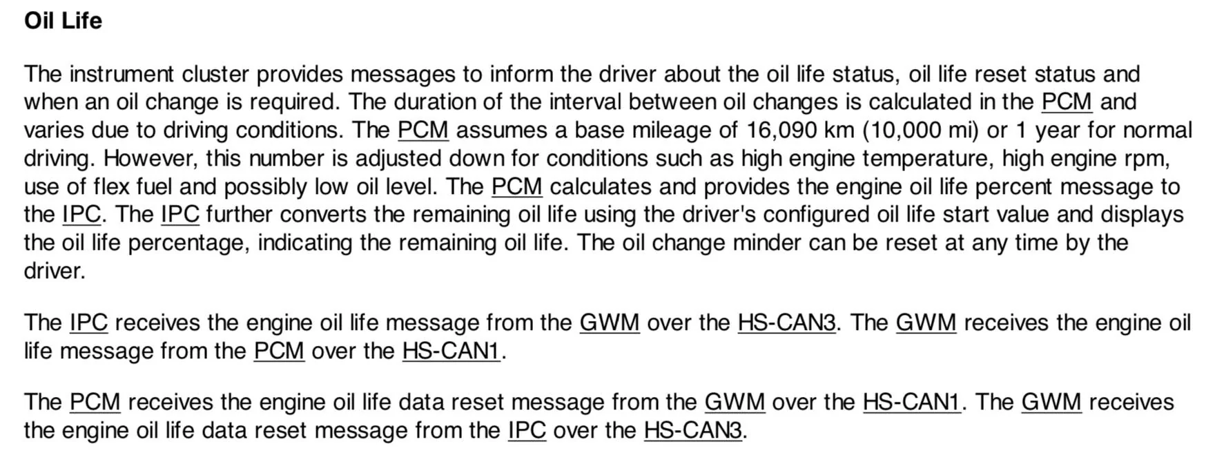

Here’s how the oil life monitor works, per the shop manual:
The timer also counts down as the car sits. So for those wondering why their Oil Life Monitor is saying you need an oil change when you have only driven 500 miles since last oil change BUT the car has been in the garage for 6 months consecutively... The above is your answer.
