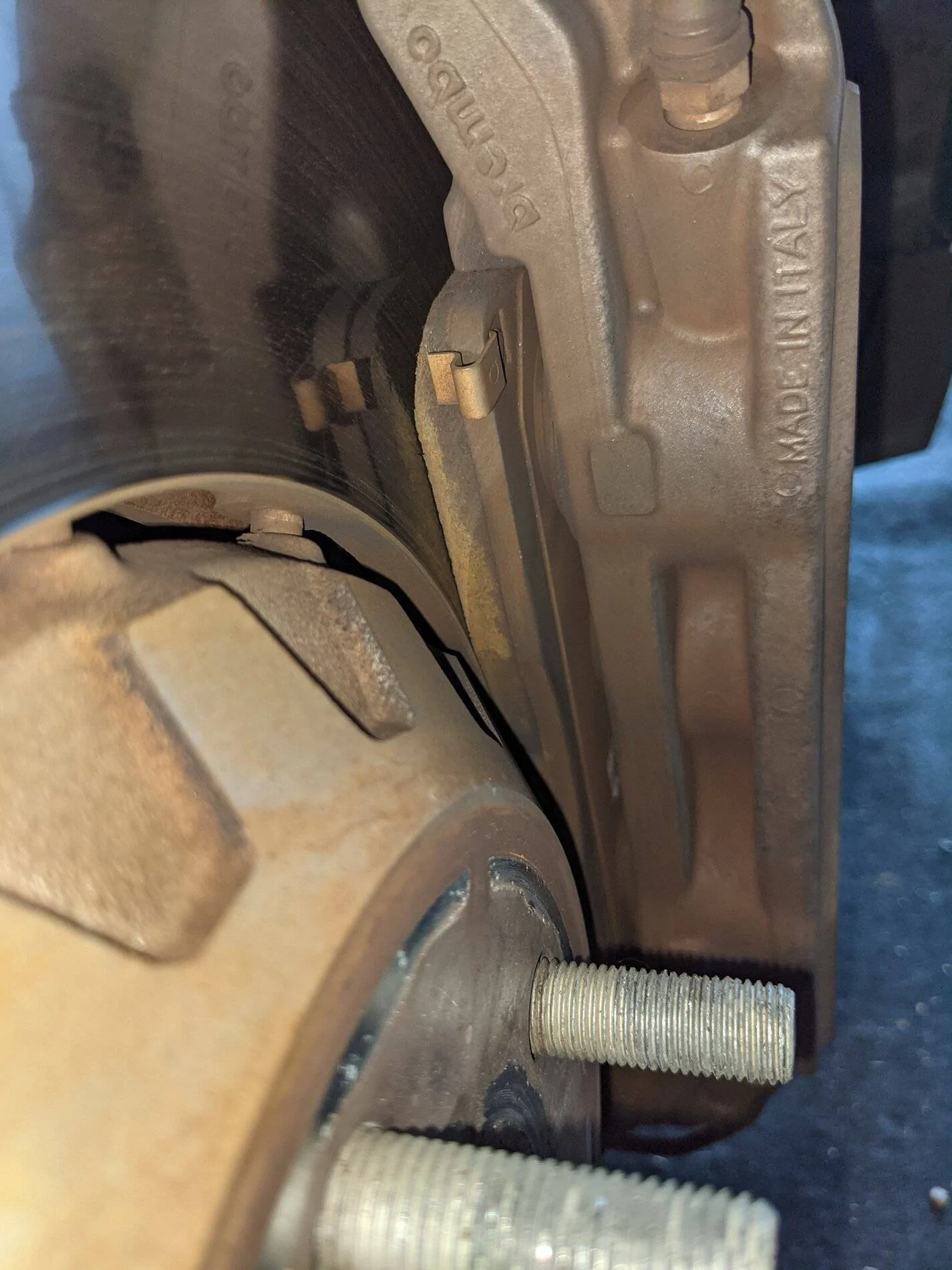

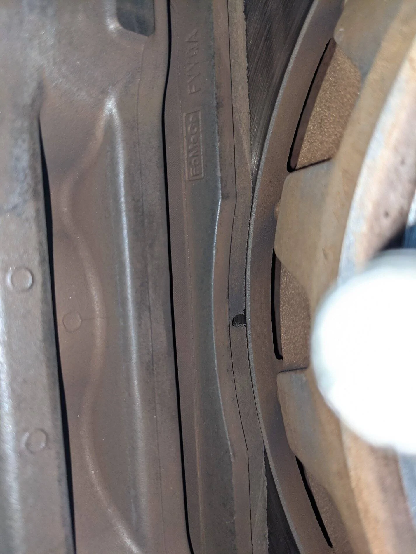

As a first avenue of inspection, I took the front wheels off to take a look at the brakes. I don't see anything obvious.
Seems like there's plenty of pad left, at least on the front. Or rather, at least enough life that I doubt it's the source of the issue.
