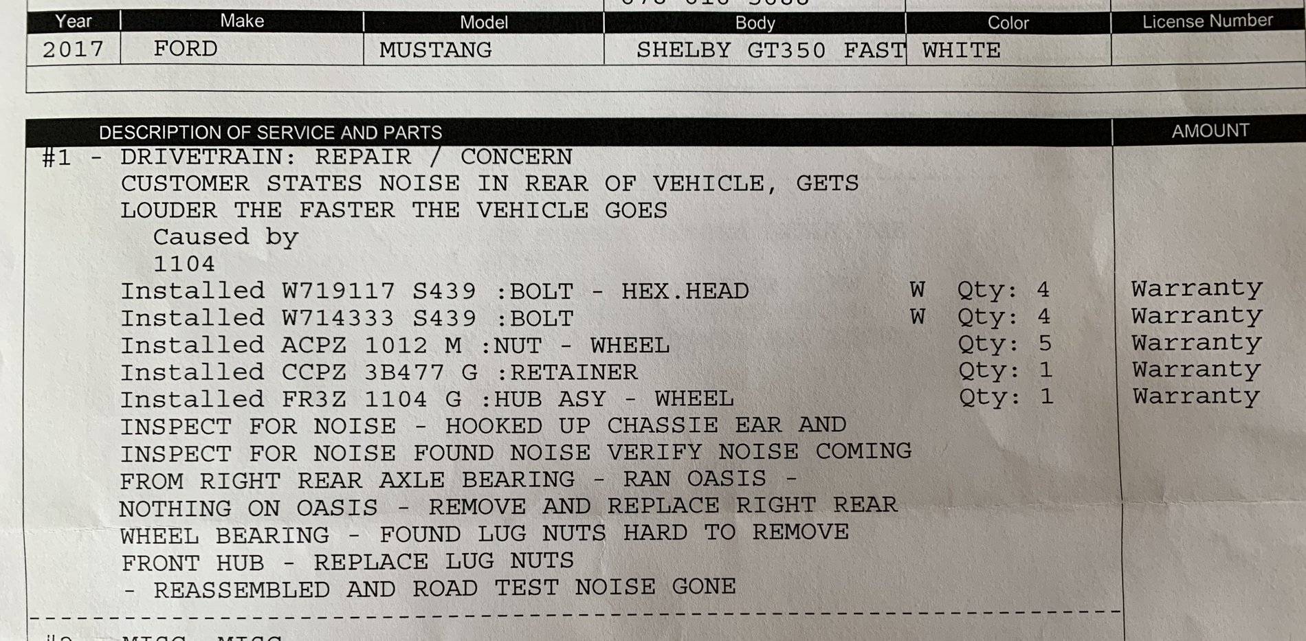

Mine developed this during a road trip. Sound only happens during hard right turns at speed and the tick started from the front left after some hard driving. It sounds like a rock was stuck in the wheel or brake or a little paper label was stuck int he spoke. I did change to the locking lug nuts before I Left. They were properly torqued. I'll have to put the other nuts back on and retorque it all to 150ft lbs and report back.
