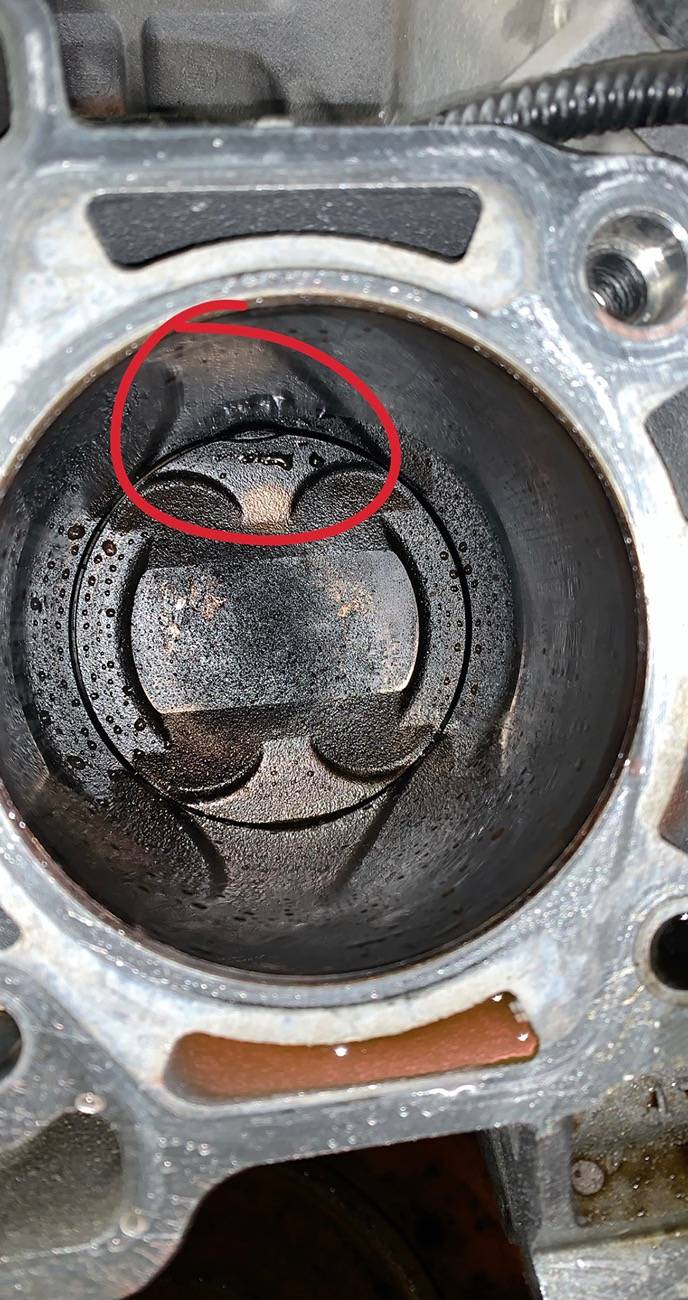

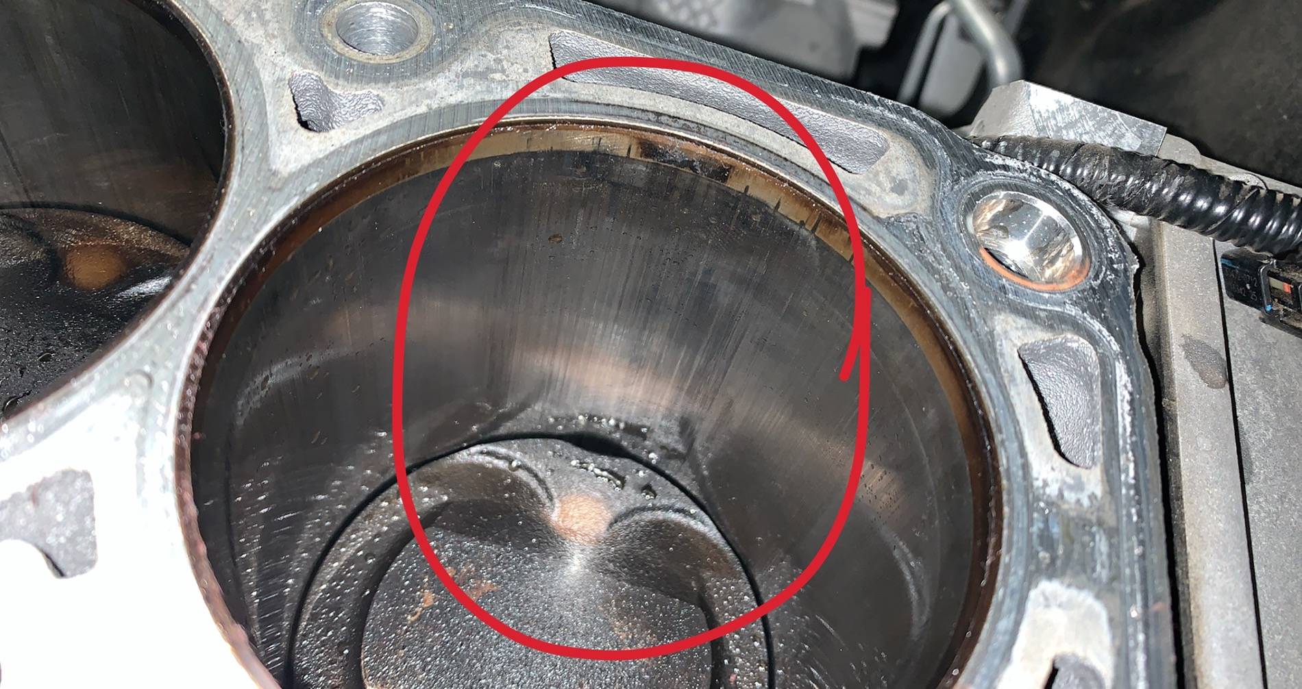

I blame the tune, detonation failures are rarely the fault of the engine
Well it’s a carb legal ford performance tune
As much a factory tune that you can get

It's not *the* factory tune though. The borderline timing changes removes some of the safety margin from high temperatures, especially on 91 octane. 91 is actually the minimum octane for that tune, it's really happiest on 93. It's like doing a track day on the stock tune on 87 octane. It's fine until it's not.

Don’t disagree with you. It’s why im using boostane as a precaution

What power pack level was it? I uninstalled pp2 as it was detonating while street driving. Extended detonation will cause engine issues.

Pp2. I know that some people have issues with it and some don’t

WAIT... does this piston shape tell that coyote is an interference safe engine? I mean money shift is not feasible?

I mean - valve shaped protrusions are clearly visible. I do not suggest anyone try to money shift, but money shift protected engine is always more that one with no protection. Of course someone might just say those protrusions are not enough.
