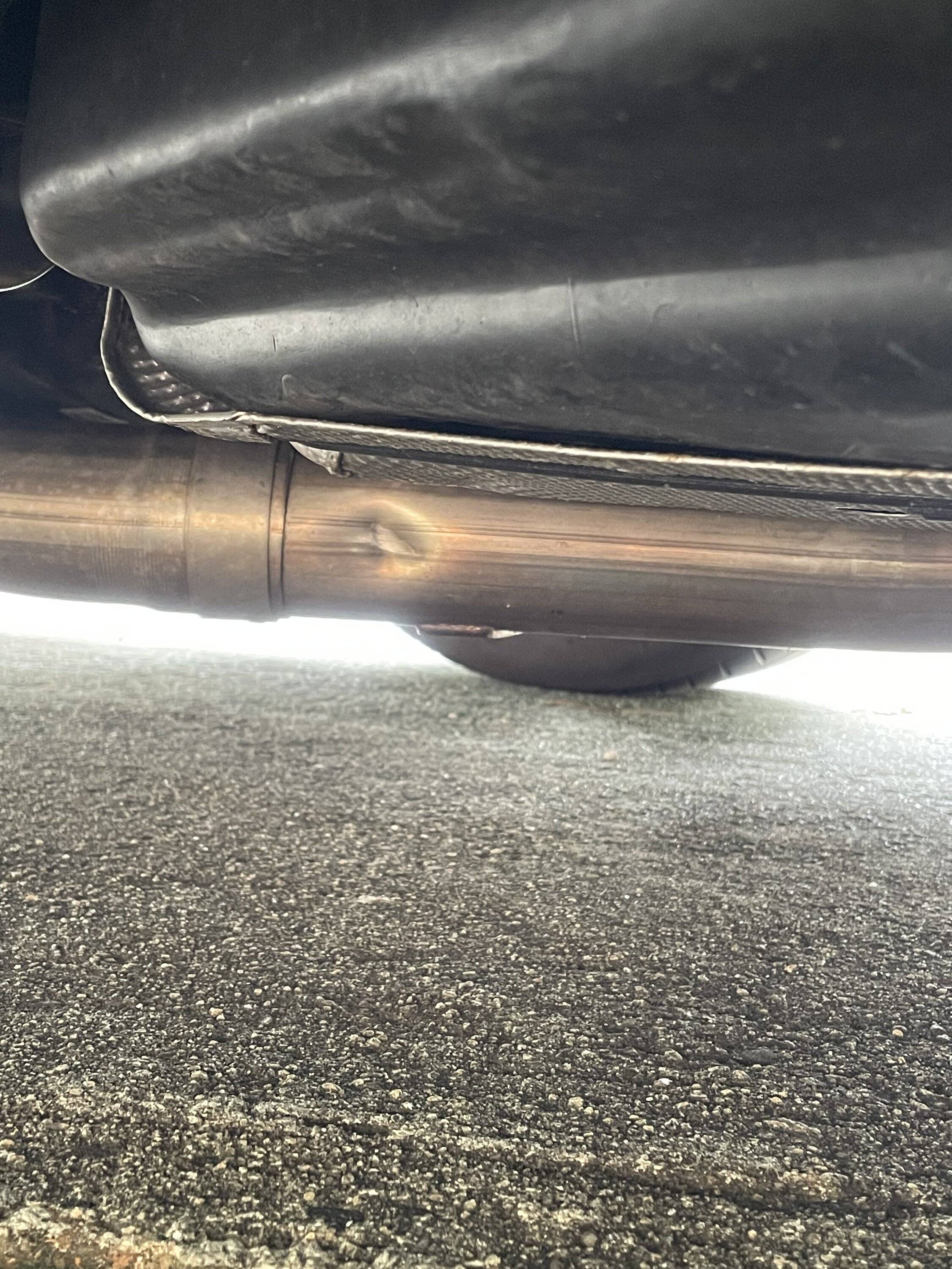

I’m just OCD but wanted to ask was driving on the freeway and something I couldn’t avoid hit and made the dent in my corsa x pipe. This wouldn’t affect performance in any way would it? I’d really rather not spend the $$ to replace if not. Luckily didn’t hit my brand new R splitter or I would have cried lol.

It sxcks, but ..ht happens. I’m ocd, wife says so, but I wouldn’t worry about that. Beautiful car.

Put it out of your mind. Enjoy the drive. 😎

If it really upsets you, hit up a local PDR guy or get an exhaust expander at Harbor Freight and just squeeze it out.

Yes, you should be fine with that dent. Ids that a OEM R Spitter? Looks Great!
exactly what i was gonna say. pipe expander from harbor
The exhaust system looks to be hanging much lower than designed.
I'd revisit how it is installed. The bottom of the mid-pipe and rear slip connections should almost be flush with the fuel tank heat shielding.
Agreed. This looks like it should be more flush with the bottom of the car.
