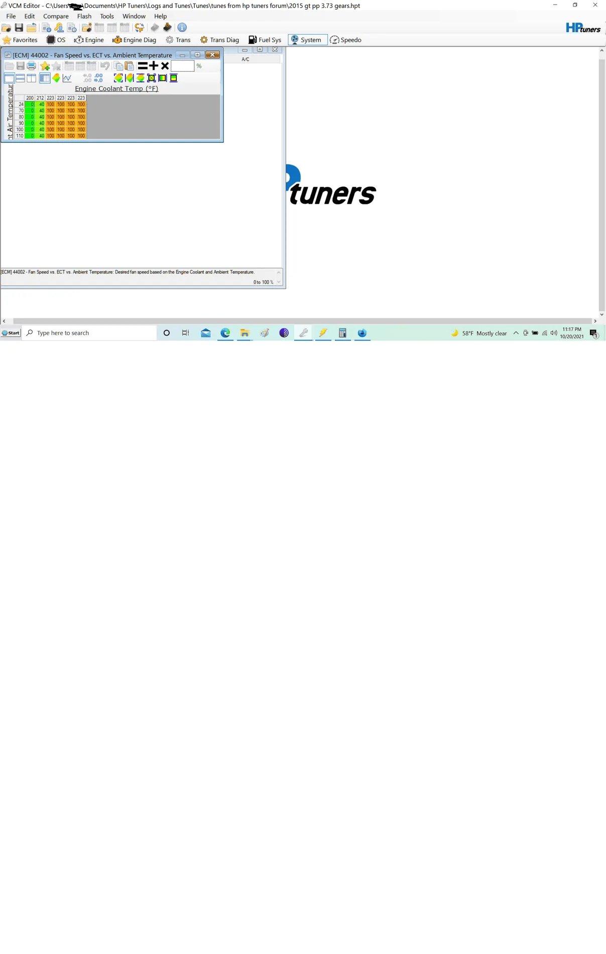

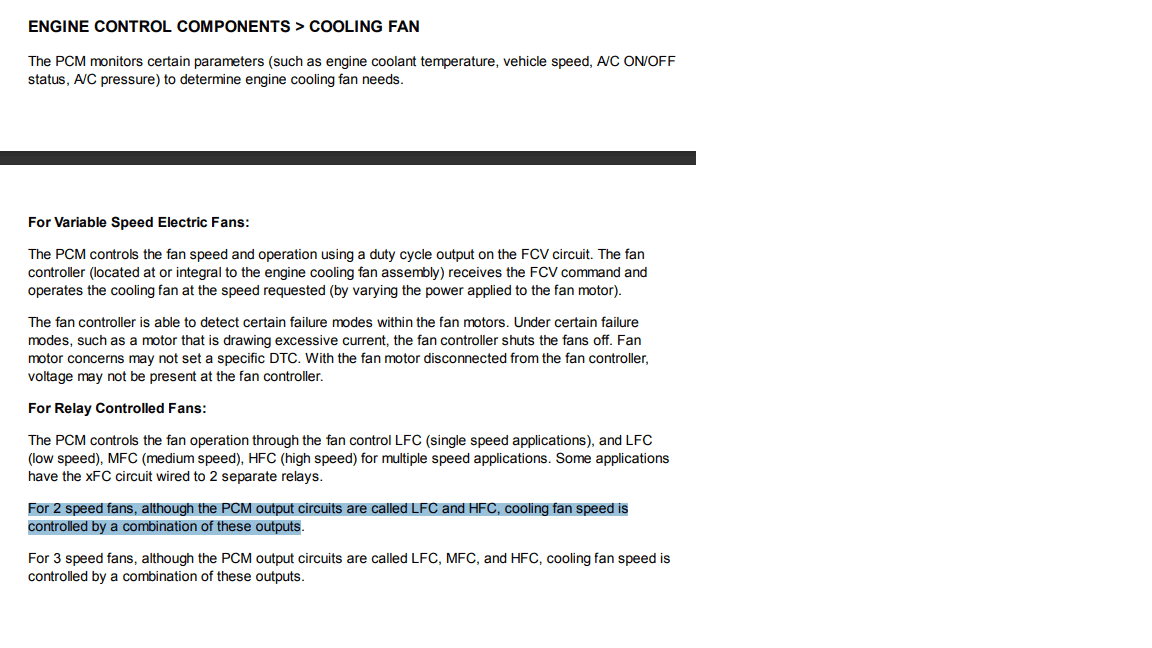

Looking at the PIDs in my 2016 EB, it seems like it's a dual-speed fan setup with a low/high speed mode for the fans. Low speed = one fan on, and high speed = both fans on. The service manual talks a bit about this and confirms that the EB fan connecters are the relay-controlled type as well and show the PCM connectors correlating to the HFC and LFC output circuits.
It also seems like there are a few variables that modify the lookup table that the PCM references to determine fan speed output.
  • Coolant Temp
  • Vehicle Speed
  • A/C Demand Status
  • A/C Evaporator Pressure
  • Not mentioned in the service manual, but possibly these also:
    • Ambient Air Temp &/or Intake Air Temp
    • Cylinder Head Temp (separate from coolant temp)
I've looked at the fan speed operation in my car, and it's definitely different based on speed and A/C power. From my memory, when I have the A/C on (doesn't matter whether it's in max defrost (heated), standard cold A/C, or Max cold A/C), the low speed fan is almost always on in idle. Where I live it doesn't get too cold, but it might turn off in very cold (<32 deg F) weather. When you're on the highway, the fan can turn off if the A/C is on, as long as it's not terribly hot out, and provided the coolant temp is <212 deg F or so. It kicks on once you turn Max A/C on though or turn down the A/C temp significantly.
When I have the A/C off, the low speed fan doesn't seem to want to turn on until the coolant gets to ~212-215 deg F, and turns off once it goes down to 190 or so (at idle). If I'm not running A/C, I think the fan turns off once you get up to speed, but it's hard to determine exactly how much, and it depends on coolant temp. I think I've seen anywhere from ~40 mph up to 50 mph as the cutoff point.
