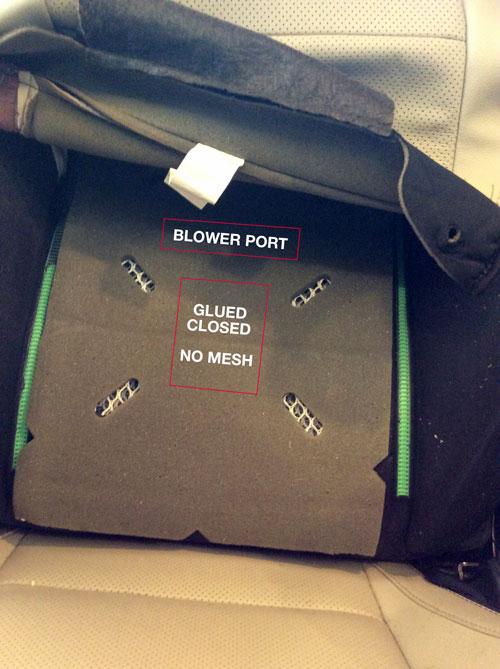

While I had the passenger seat cover pulled up, I took a photo of the inside. The mesh that the cool air is supposed to be distributed through does go all the way down the seat. The mesh is behind a piece of foam but there's 4 holes in that foam where you can see it.
There is a portion in the center where there's no mesh. I roughly indicated in the photo where the blower port is and the mesh free area. The glued part might go all the way down the middle of the seat though. I need to do a more thorough investigation.
I'm not sure why the cold air doesn't spread throughout the seat better. In heat mode it seems to spread out quite well. Perhaps it's because the hot air in heat mode is a lot hotter than the cold air is cold in cool mode - makes it more easily perceivable.
Also note that this is the passenger seat. The driver's seat might be different because of the lumbar support. I don't have any other reason to open up my driver's seat, so I'll have to leave that to someone else to investigate.

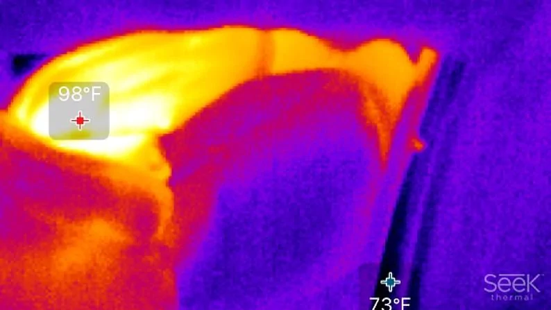

Here is where I disagree with Darko66. The exhaust air is a MAJOR issue! The TED produces hot exhaust air when in cooling mode. The HOT air has no where to go and will get trapped inside the seat. As the unit runs for a long time it will continue to build the internal seat temp higher and higher and continue to reduce the efficency of the system. Eventually after long runs the TED will start pumping out warm air instead of cool air.
What did I do? Well I approached the hot exhaust first instead of the intake. My goal was to get the hot air out. How do I know the hot air needs out? This FLIR image.
