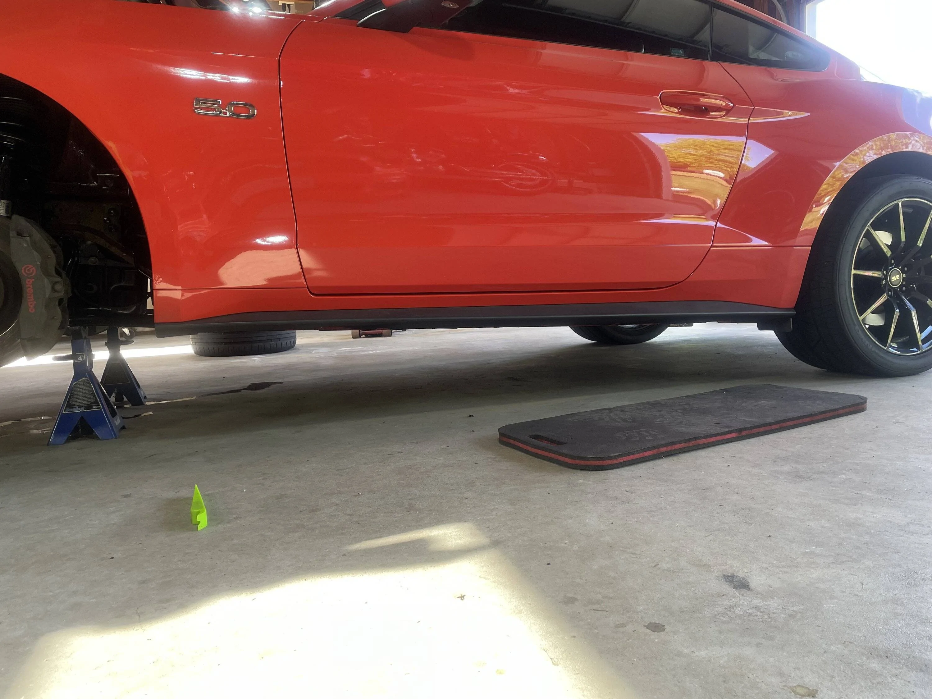

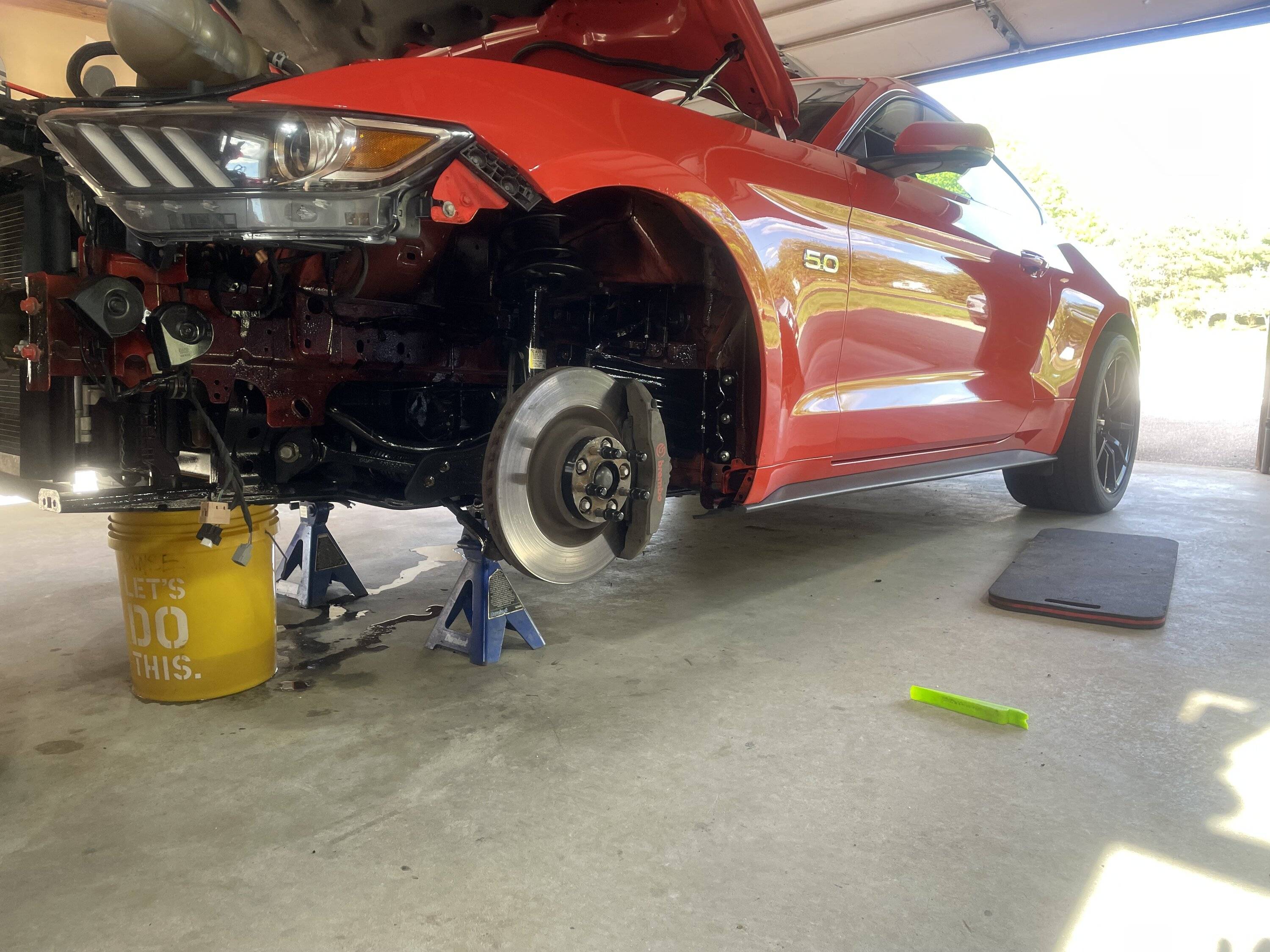

I opened the radiator drain valve, loosened cap, moved degas bottle so one line is totally disconnected, disconnected upper radiator hose, and lower radiator hose from engine side, only got about a gallon in my bucket???
i think i saw capacity was like 3.1gal for a PP1 GT, so there should be way more in my bucket.
Did a search, they said to raise it high enough to drain radiator, it's at a decent angle but not super tilted.
anyone got any ideas to get the rest? degas bottle was at the normal line when i pulled it so i don't think it was empty and never overheated once even on track

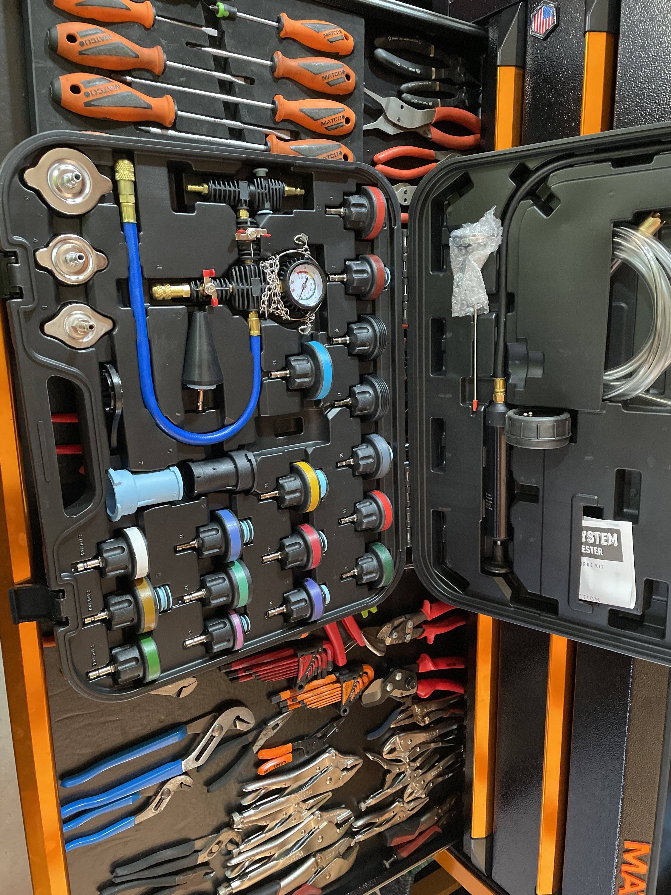

Airlift coolant extractor/refill kit. You won’t get 100% of the coolant out, (maybe 80%), but you can extract, refill and extract a couple more times to get all old coolant out.

I bought this kit here, this should do the job then no? It's it's a pressure/fill and test system.
will this work or do i need to buy the airlift brand specifically

That looks to be the same thing as an Airlift with plenty of fittings and adapters. It should get the job done nicely.

It's because of the angle you have the car at. You'll get more if it's level end to end (or if the front is lower than the back). The majority of the coolant just sits in the block.
Ok cool I'll go take out the Jack stands i have out there tomorrow morning and lower it down some!

Try and follow this method with your extractor/fill kit. You’ll know it’s full when the vacuum gauge goes back to zero..
