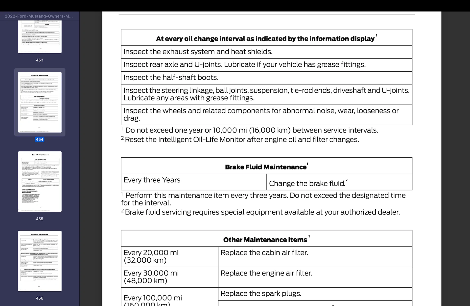

Is there a reference specifying coolant replacement every three years?
Brake fluid is replaced every three.
The liquid attracts moisture, which changes the viscosity of the fluid.

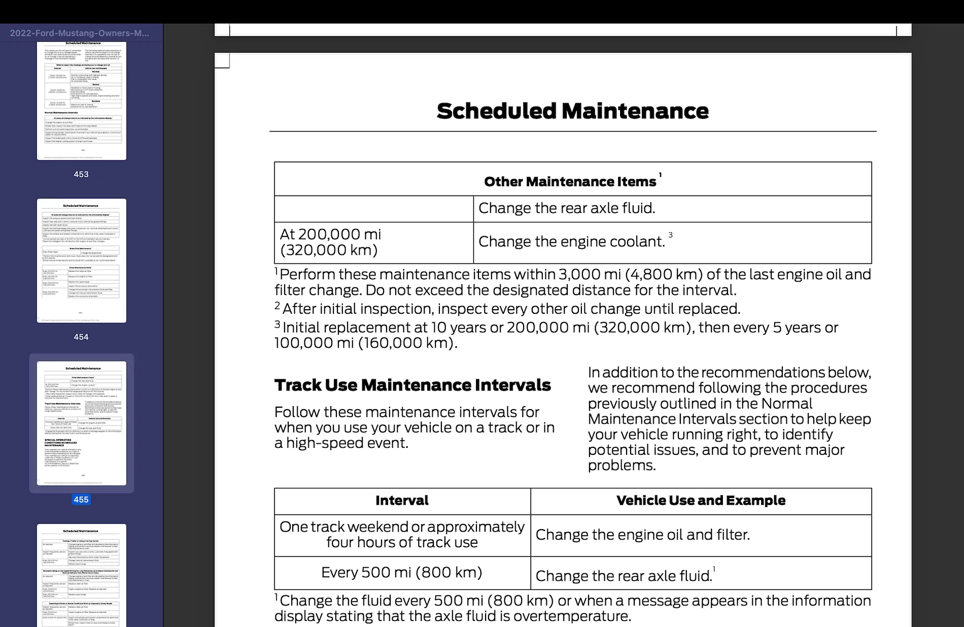

I'm showing '22 and '23 initial coolant replacement at 10 years or 200K miles, whichever is first.

The liquid attracts moisture, which changes the viscosity of the fluid (affecting ABS performance), lowers the boiling point of the fluid (loss of hydraulic function) and can enable rust to many of the internal components. The properties required of the fluid to operate the braking system correctly are compromised.
