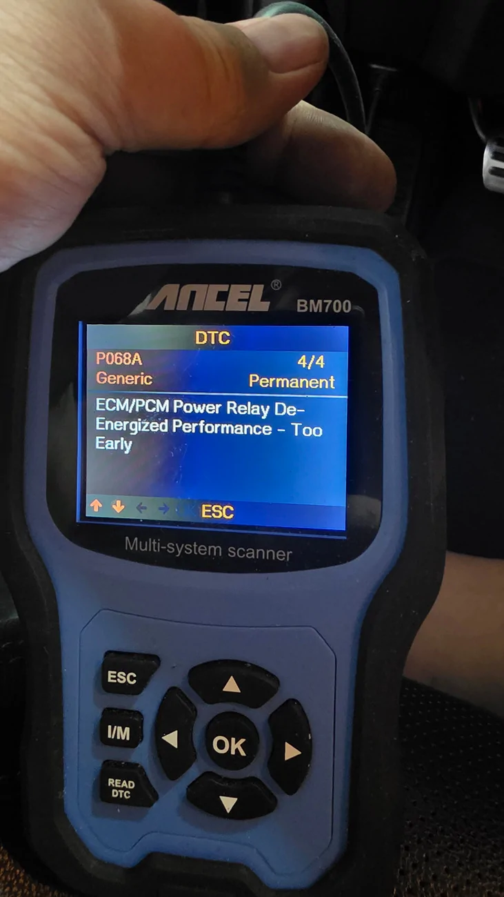

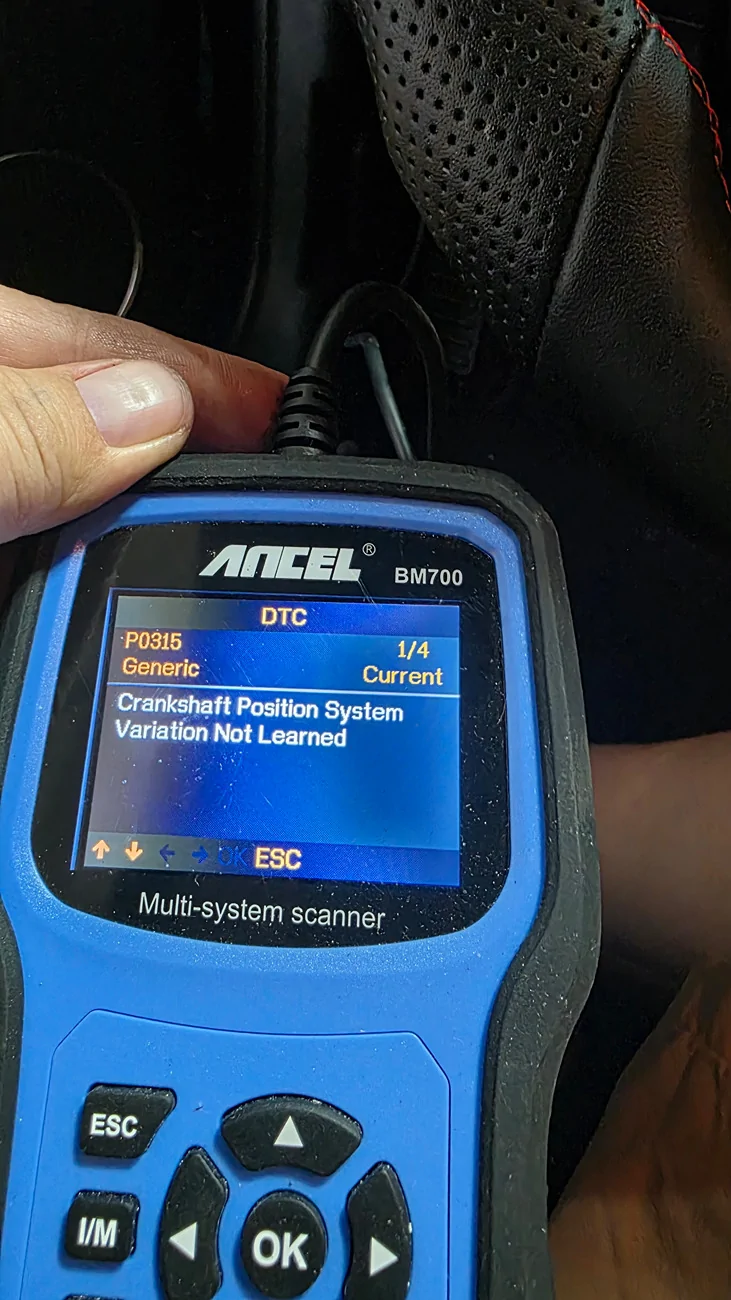

Hello all. A friend of mine with 2015 GT decided to do what I did to mine. He purchased a GT350 TB and JLT intake and a Lund tune. I helped him with the install. Just like I did on mine, I backed up the stock tune, disconnected the battery and proceeded with the install. At the end we flashed the tune he received from Lund using their device. All was smooth until he started the car. There are 4 codes. 3 of them are the p0315 - Crankshaft Position System Variation Not Learned, and the other one is P068A - ECM/PCM Power Relay De-Energized Performance - Too Early and his cooling fan is stuck on. We tried to reconnect the battery, checked the terminals, cleared the codes and they keep coming back. Not sure what it is about since mine had no such issue. Fuses look all ok. We did not touch any wiring except for the MAF plug. Battery is putting our 13.6v. Any ideas would be greatly appreciated.

The first one you can just clear. The second one you need to do a simple crank relearn.

We did flash back to stock but the car runs like complete shit, so bad that he's aftaid to even keep it running long enough to check the codes. He's got the intake that requires a tune plus the bigger throttle body. No issues before the install. We'll try to flash while the battery is connected to a charger and see if it makes a difference

Well, the charger solved the issue. Thanks to everyone who recommended it. Hooked up a battery charger. Flashed it again and the ECM/PCM code is gone. Did a relearn after and its all clear now. Thanks for the suggestions everyone!

So you did the relearn procedure (not a simple clearing of the P0315 code)? You might have to try it again. I had to run that every time I loaded a tune on my GT. But that was the only code that popped up for me.

Yes, I had to do a relearn on his car, otherwise the code wouldn't go away. I had no such issue when I did my car tho.
