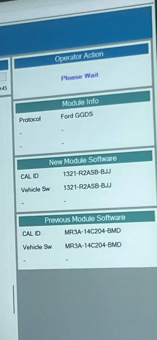

I don't have a known 2021-3 Roush mustang tune on hand, but the 2018-20's that I have show that Roush barely touches anything in the transmission tuning. If you post your strategy or OSID I can pull it up and compare it to a stock Ford file.
I took this photo when we flashing the PCM, not sure if this helps. Appreciate the help!

Through PCMTec, I have access to your stock file and that Roush file, and can compare them. As far as the transmission shift firmness goes, here are the changes I see:
- The 3 shift firmness characteristics are still assigned to the same drive modes. E.g. base is character 0/soft, paddle shifting, sport, sport paddle are all character 1/medium, and drag is still character 2/harsh.
- Small amount of stroke pressure added to various shifts at various torques and rpm. I don't think this would affect shift firmness.
- Character 1/sport shift durations reduced for 1-2 at light throttle, increased at medium throttle for 3-4, and changed for 4-5 (some faster some slower).
- Most of the shift maps/schedules were changed but not dramatically.
- Minor changes to the TCC slip maps.
- Various minor changes to the clutch torque transfer rates.
- 3-4 shift torque modulation reduced at light throttle and increased at heavy throttle in both base and sport modes.
Honestly, most of these changes were probably done by Ford as part of various routine revisions and Roush probably started with a different base file so you inherited these OEM changes as well. Some of the changes are from Roush but those wouldn't make it harsher.
My suggestion is to drive for a while and let the adaptives learn. It might smooth out, as I don't see changes to the tune that would make it consistently harsher than stock. If you still don't like it, I'd recommend getting PCMTec software and dongle and you can customize the shift firmness all you want.
