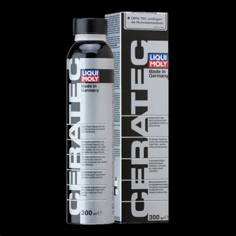

Its when moving and when in neutral. I assume adding Ceratec kills any warranty added to the car? I have a good chunk left of warranty.
Don't want to lose it but don't want them ripping apart a 14,000 mile car to find a mystery noise that is assumed to be harmless.

Thank for the replies everyone.
I do not believe that to be the case. Ceratec has been the answer to the BBQ tick for quite some time. Liquid Moly is an additive in many oils anyway. I have not heard of anyone who has had a warranty claim being denied because of it.

This sounds exactly like my old 2020 5.0 BBQ tick. Just add some ceratac and call it good. Absolutely hated that sound..

Happens. As others have said, Ceratec will fix it as it has done to mine, or swap to a good 5W-30 oil. Either will fix it—no need for both. I've been running 5W-30 for a while now, and the tick's been gone, at 105k miles. Personally, I suggest stepping up to 5W-30, or try out other oil brands—Pennzoil, Mobile 1, etc.

As has been mentioned many times, unfortunately that sound is normal.. Well not normal, but doesn't hurt anything, Ford will say working as designed. My F150 with the Gen 3 Coyote was VERY noisy like that. Drove 100k miles and was still running strong when I traded it. Ran Mobil 1 5w30 in it, put Ceratec in it and it made a big difference...
My 22 GT wasn't too bad, but I did use Ceratec and switched to Liquimoly Molygen oil. That oil has the Moly in it already.
I run Molygen in my 21 Mach 1, no issues yet. 20K miles.
