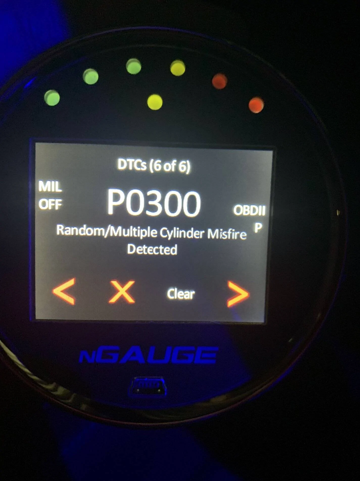

I down shifted hard (MT82), and all of a sudden power was cut from my engine and my CEL started flashing with the engine driving rough. Thought it could have been a dying battery, but my Ngauge says “Random/Multiple Cylinder Misfire Detected”
I reset codes and tried starting again, and it became very rough again so I shut it off right away.
Note: I am tuned by Lund on E85R.
Should I be worried this is something catastrophic? Any advice and help is appreciated thank you.
I also have a few different codes that previously showed up, but was never a bother again (P0017, P0015 camshaft position and timing). I’ve been on E85 for almost a year..
