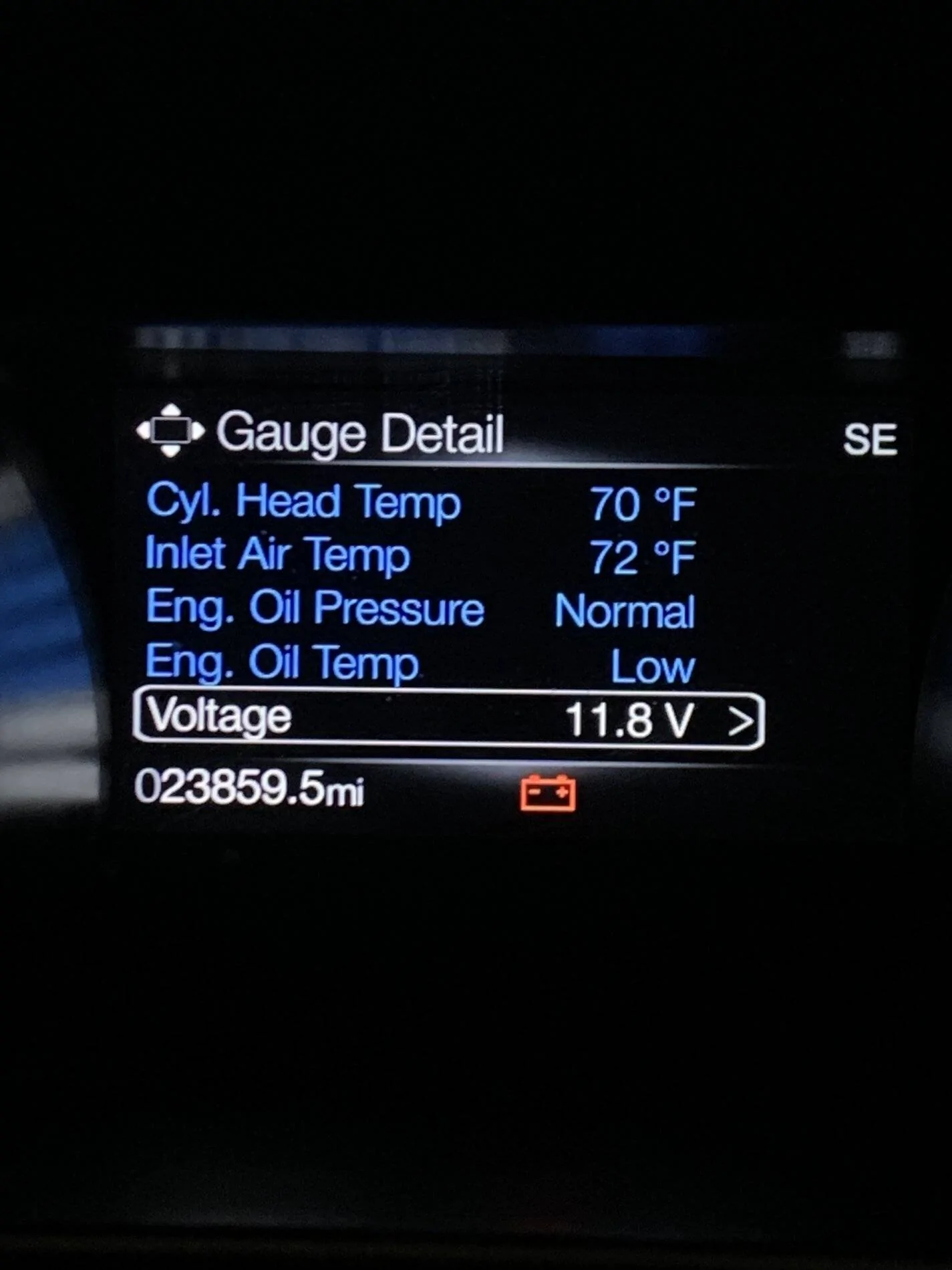

After 24 hours of sitting, your battery should read 12.45-12.6V at rest with no load.
Will get back to you on that after 24 hours lol! I believe it is below that in fact.

So sitting at rest with no load it's at 11.8V, and when driving it's 14.4V.
That is not a “no load” condition. Having the ignition on draw current from the battery
No load would be testing the battery with a voltmeter and ignition off
That say I do agree that the voltage seems low
Also, how can the oil pressure say “normal “ if engine not running?

With just ignition on, mine shows 12.4v.
Best way is to put a VOM on the battery the next morning.
