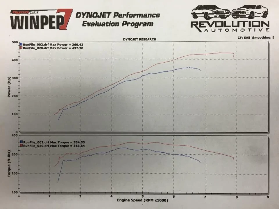

Did he ever post a dyno graph? Im not interested in the numbers. I would like to see the curve with the CobraJet.
No still waiting, just posted he made 415HP.

This was a rev auto car with headers,cj , auto Trans. SAE numbers. Would be about 20hp more with a 6 man Trans they said.
Numbers are off due to a 3rd gear pull because stock gears in 4th ran too high speed for dyno.

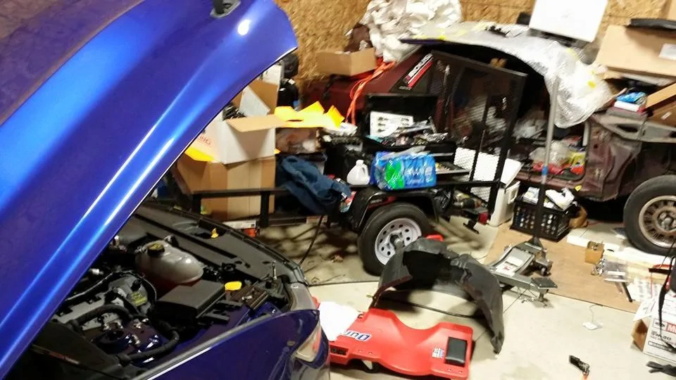

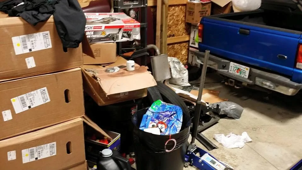

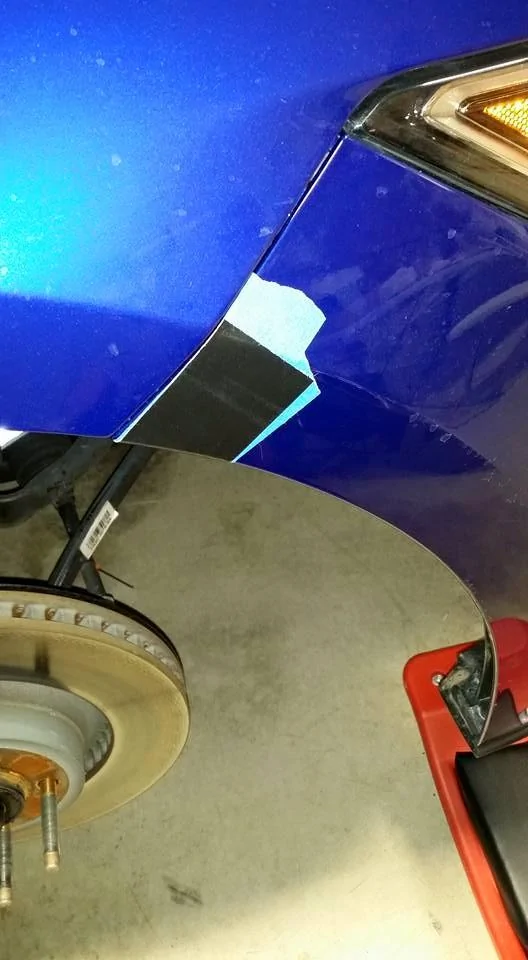

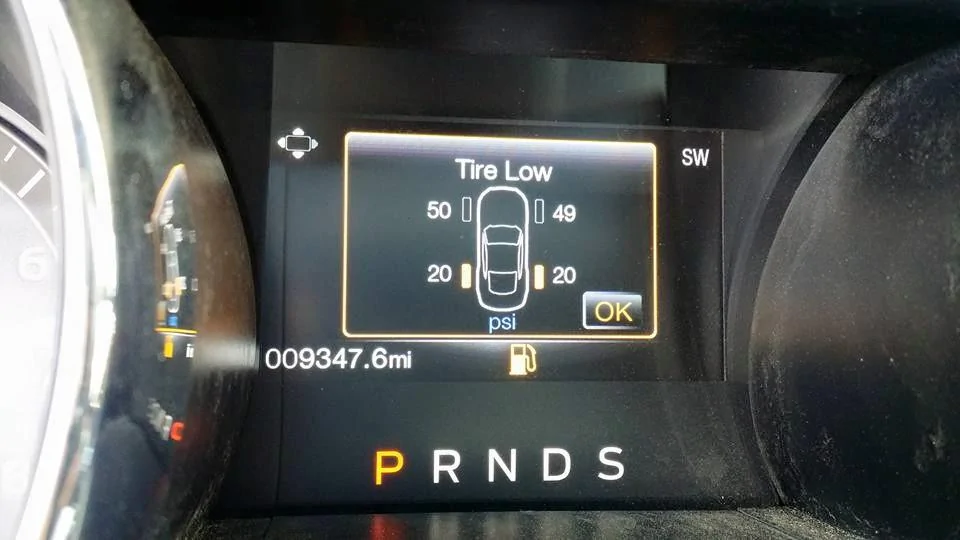

Next some pics, first the time slip, 8 in all but this is the best. I forgot to mention the car has been driven over 300 miles between two tracks two days in a row, so yes it's road worthy. Trailer damage repair from dyno day. What a shop looks like when working 11 hrs a day at work then working on your car in the evening. No special tools just determination to make the S550 be the next Fox Body.
