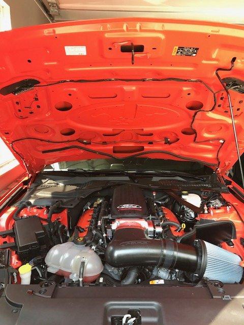

Did you have to drop the engine to make it fit?
No, Just trimmed the hood.

Ahhh I see! So the clearance issue is only towards the back of the manifold, the rest of it clear up fine then? Good to know!
And what problems have you experienced with the pmas? Heatsoak? Heard the open box-design is prone to have those issues...
No, had to trim up front by the pony and 1/2 way back also. The lettering was lightly touching.

Yes I have noticed in traffic IAT skyrocket, then it takes a bit of driving to get them down....
