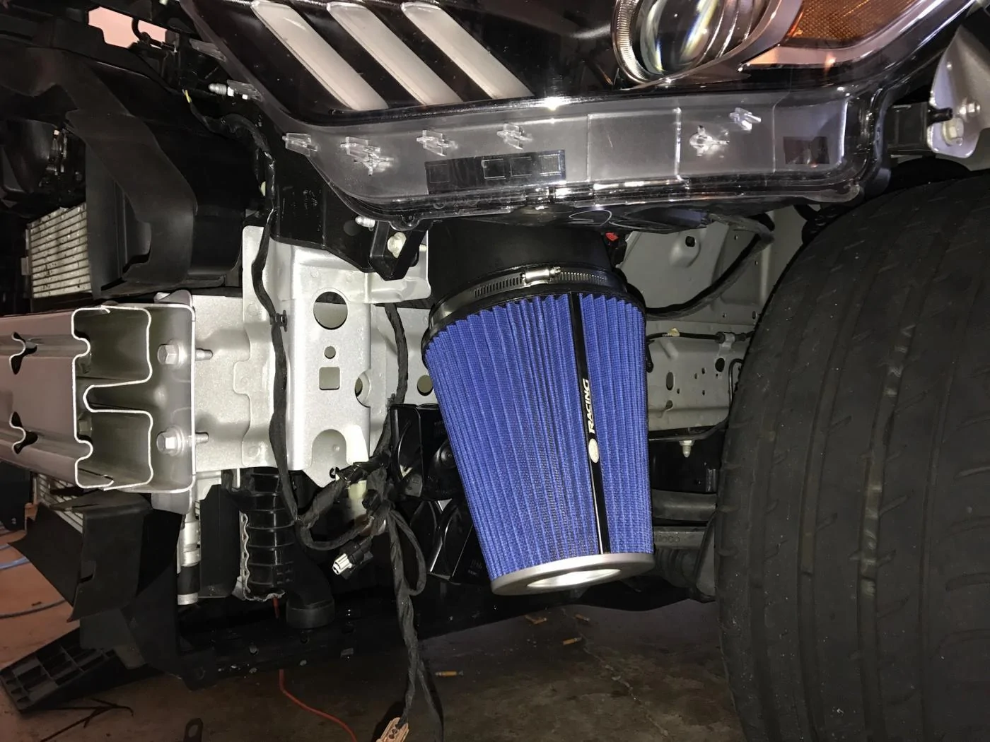

New CAI for CJ
For all you CJ runners, I finally got everything running and tuned right with my new CJ cai. Tuned by Jon Jr @ Lund Racing. He did an amazing job! No driveability issues and it pulls harder than the frpp cai. I ran it at the track and the humidity was pretty high, but I couldn't get it to stick with Hoosiers. Got a lot more testing to do at the track to get it to stick.
For those of you that will ask, there was a bit of modifications to the radiator and just that entire area to get this cai to fit properly; this was no easy swap. There was quite a bit of fabrication involved. The radiator has to be moved forward about 2 inches which involves relocating the lower radiator mount, machining the top mounts, fabricating a bracket for the overflow tank, etc, etc. don't think you can just buy the cai and drop it in.
Looks ace and is certainly one way to keep those IAT's very low, just don't drive through any deep puddles. ;)

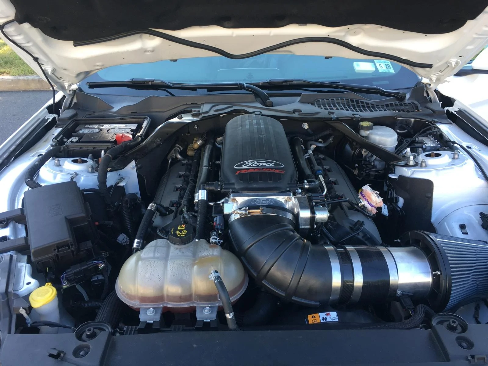

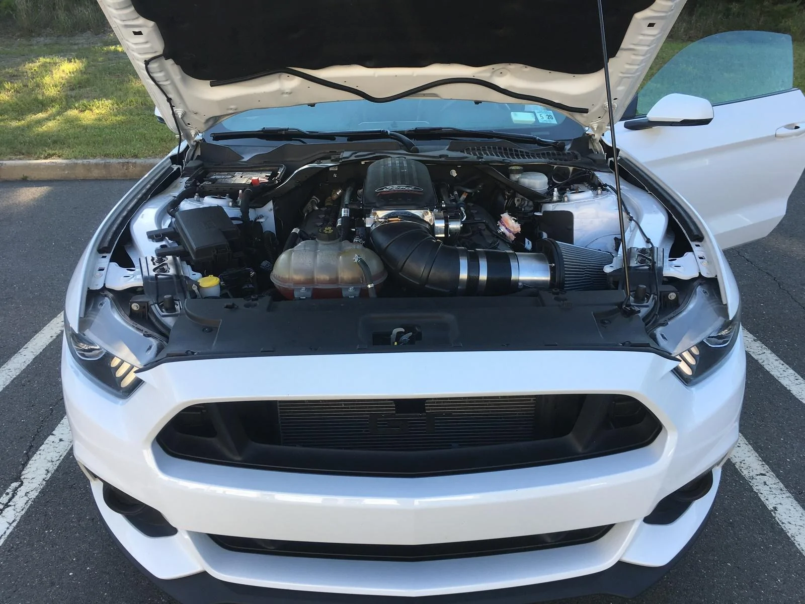

installed mine this weekend couldn't be happier!
I was worried about that so I put an outerwears water resistant prefilter on it. Good to go!:headbang:
Did you have to cut the body to put the intake tube/filter through to the fenderwell area or is there already a hole there?
As far as the custom work you had to do, I wonder if a custom bent intake tube would have meant less chassis work to do? The CJ intake tube seems like a straight shot down which is why you had to move the radiator, but if you got a custom intake done with a little bit of a bend here and there would have fit around the radiator. May not be as pretty but should be easier to implement.
