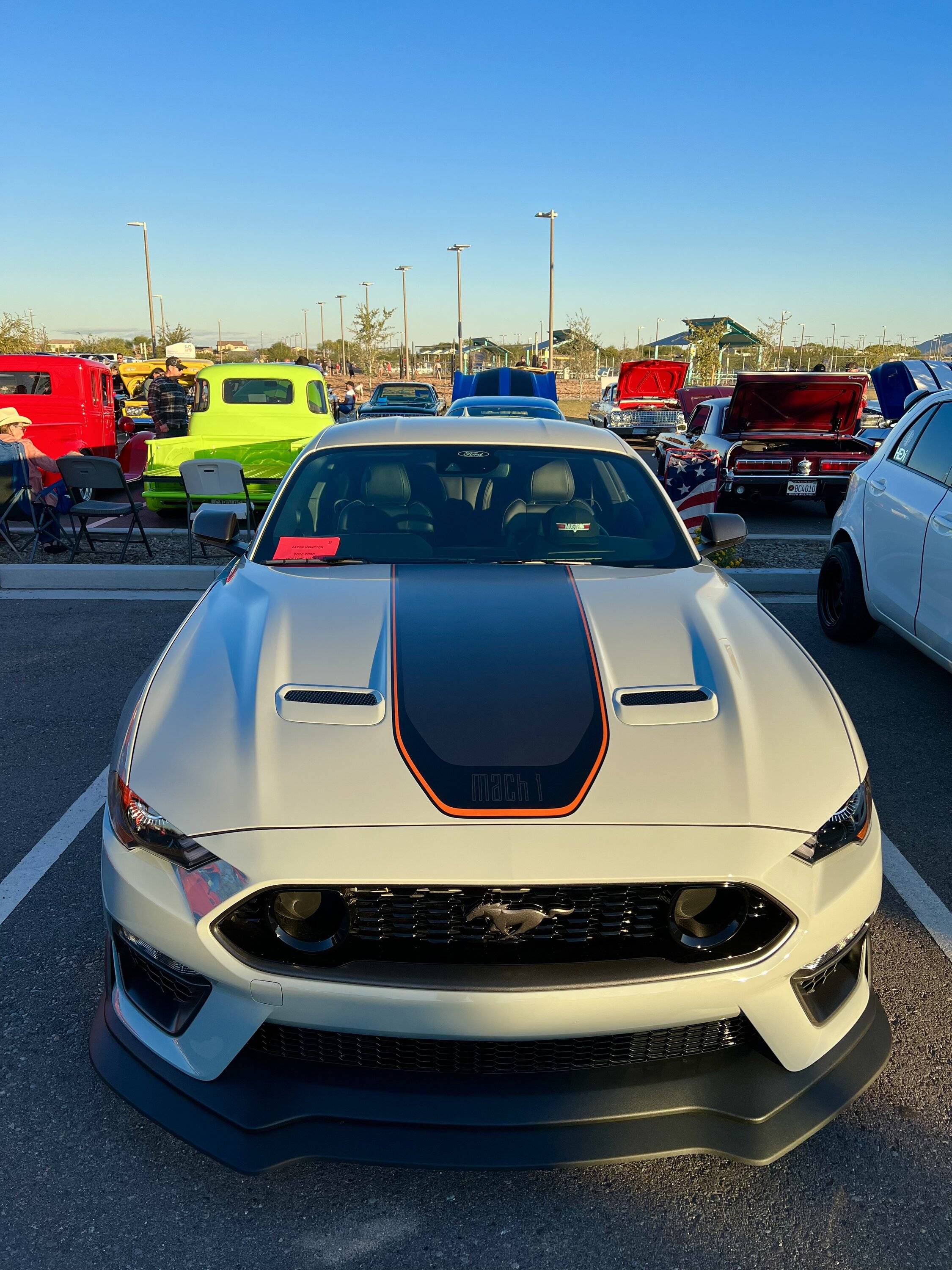

I put Adams Graphene Spray Coating on my car after properly preparing the paint. The stuff is amazing. Easy to apply and remove.
I am maintaining it with their Regular Car Shampoo and the Graphene Shampoo every other wash. Using their regular detail spray as a drying aid. Topping with regular CS3 at the end.
Next round I am going to finish off with the Graphene Boost to see what that is all about.
Big fan!
