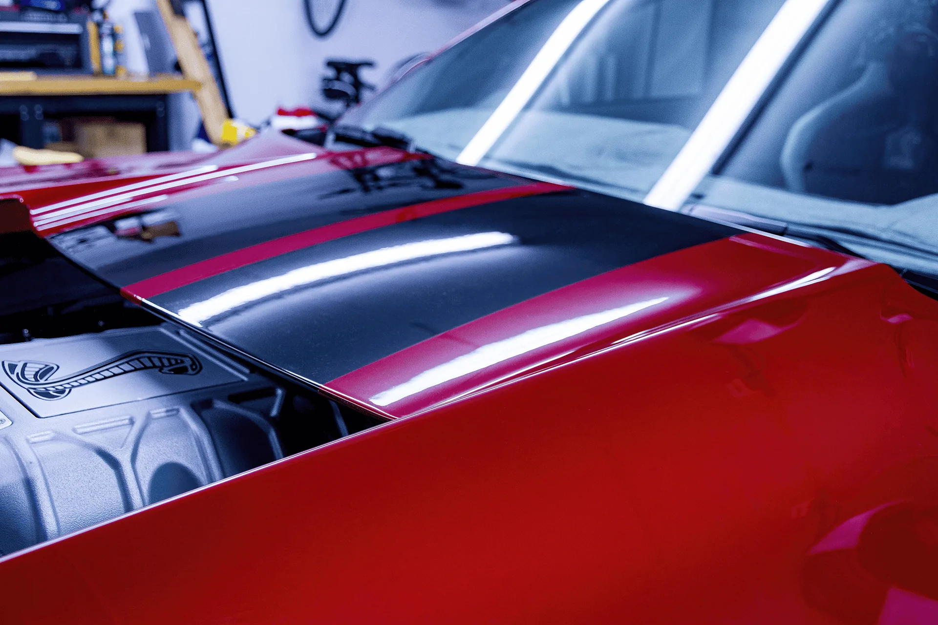

You don't "lock" anything in with a ceramic coating, you can polish through it with the proper compound and pad. The longer a coating has been on a vehicle, the less compounding required to remove the remaining portion because it abrates off.
But, if you don't want to spend the money to have the car polished and coated and, you can't or don't want to polish it yourself, stick with wax. Coating an unpolished car is not the way to go even though it's possible and will make it easier to wash. I spent five days polishing mine and the difference in gloss from the factory was dramatic. But, if yours is good enough as is, go ahead and coat it, at least it will be much easier to wash for a year or more.
