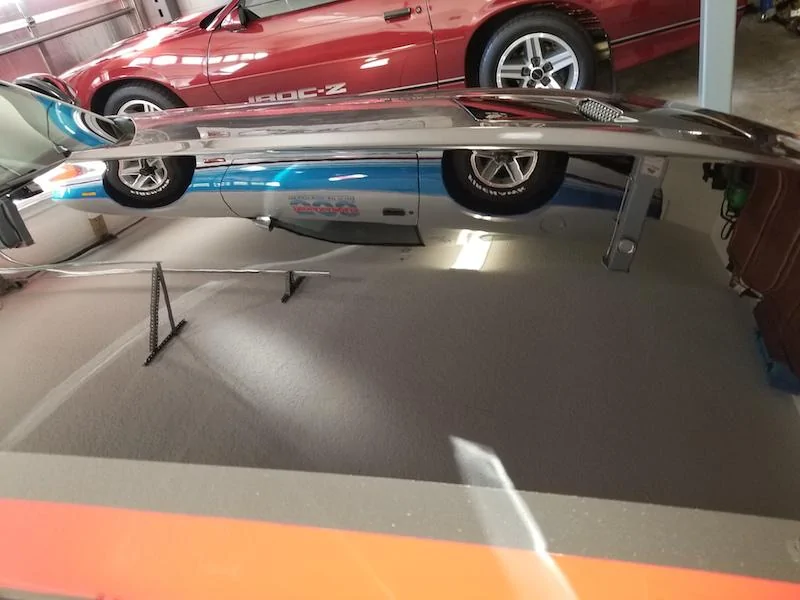

So, I spent some time yesterday compounding and polishing the car some more. I went in for window tint last week and saw nasty sanding marks in the paint when parked under their lights, so I figured I should fix this. I used Meguiar's #100 compound over the entire hood, then followed that up with Meguiar's 205. I topped it off with some NXT 2.0 to keep it looking good until I get the entire car polished up. So far, just the top surfaces are like this. I'm getting closer to getting the paint where I want it.
