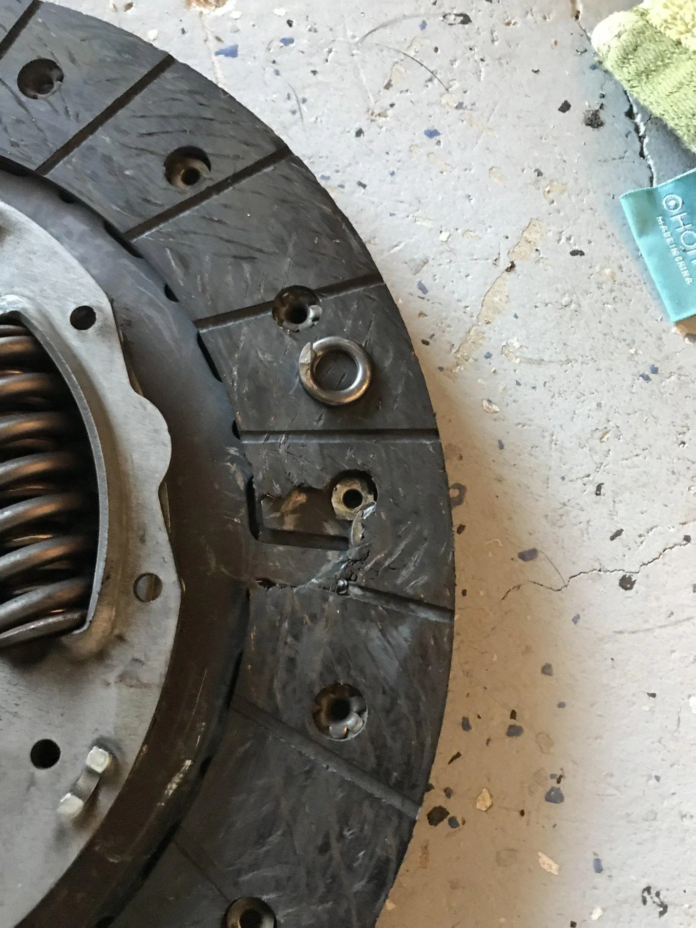

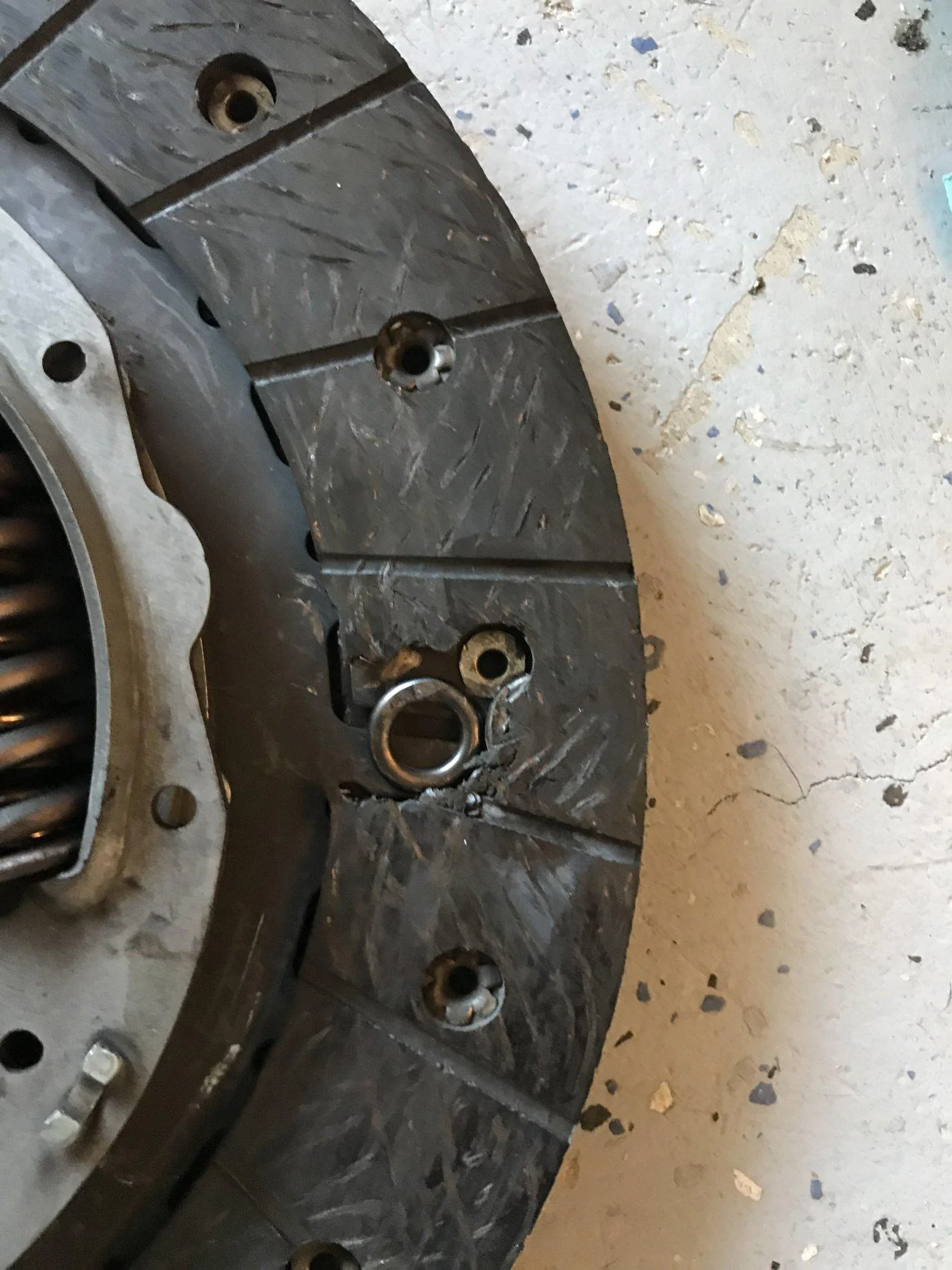

Is that a piece of the spring?

Did you have any weird clutch pedal vibes during disengagement or bite point?

Is the Exedy a low quality part? This failure mode is unusual. Did you contact Exedy about this? What did they say?
I think that's the stock clutch. He was planning on getting the Exedy as a replacement I believe.
