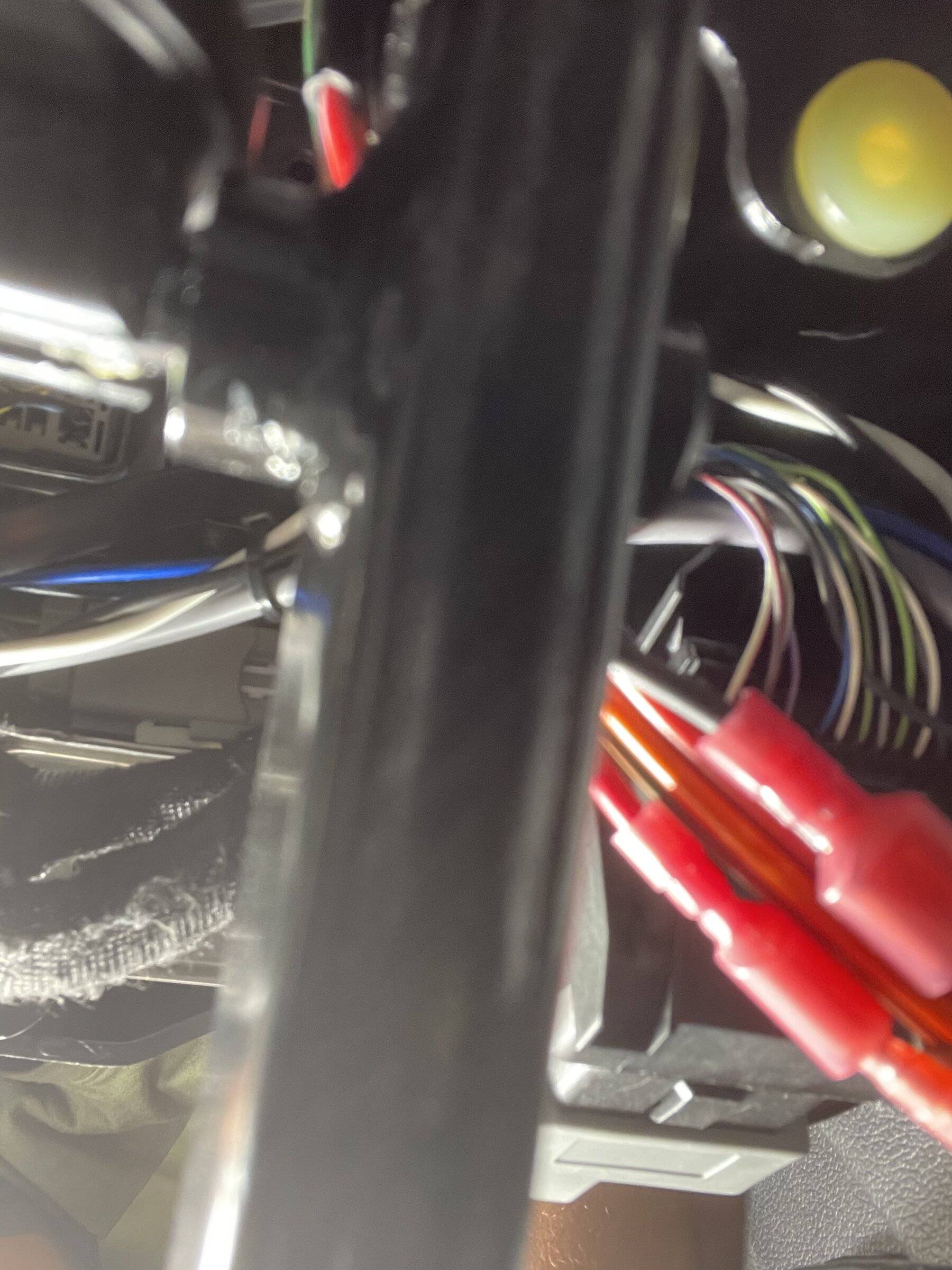

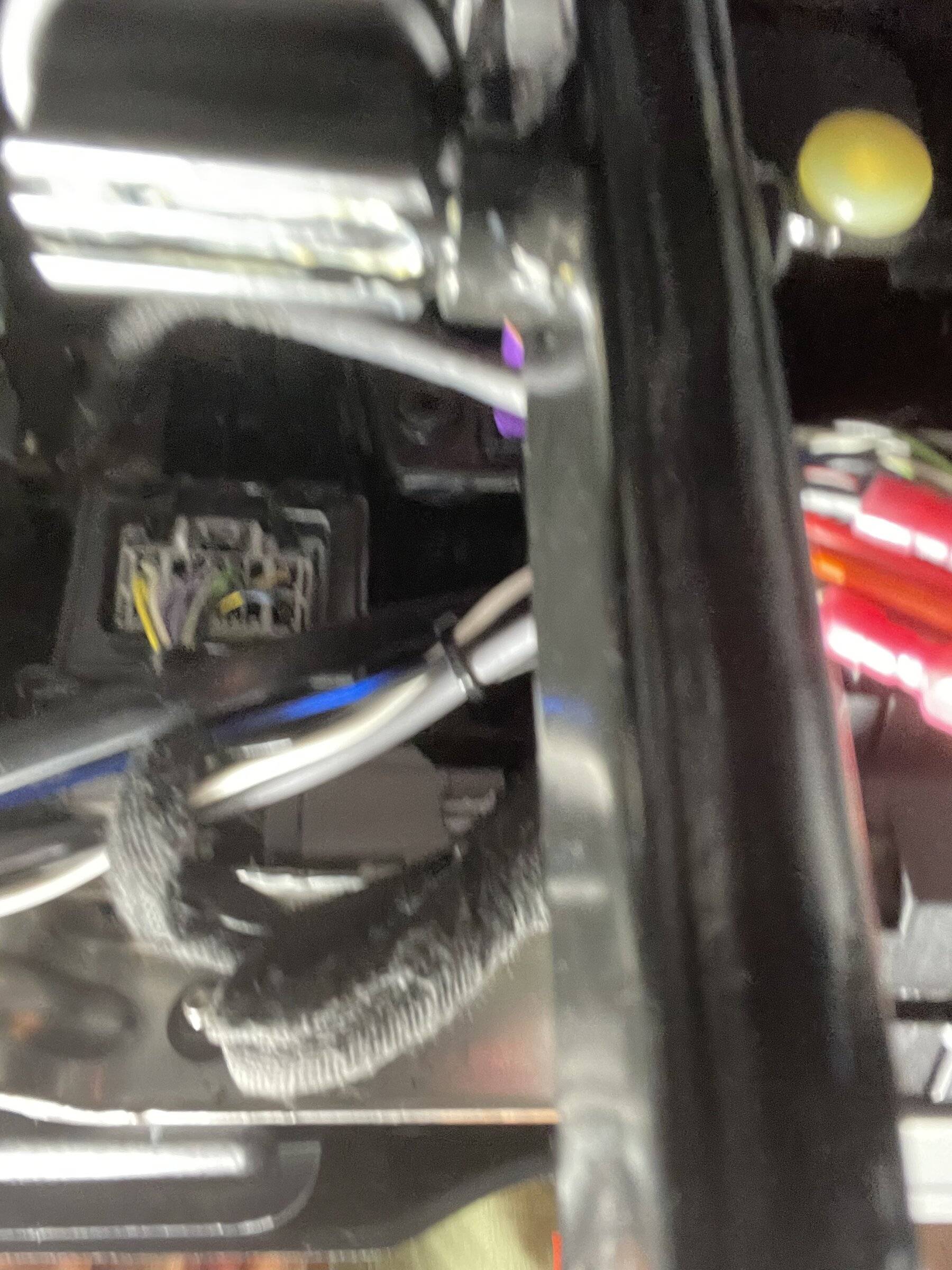

Mine squeaks too. Very irritating. Started about 2k ago, at 14K now. Was thinking some lube would do the trick, but haven't had the motivation. Installed the Steeda spring the first week of ownership. Probably need to check it out soon to confirm it's not the welds cracking, but no lateral peddle movement. Wasn't the weld problems only on the 15-17s?
The weld could and should have been laid all the way around the pivot shaft. These pics are not the best, but I don’t see any signs of cracking and damage to the weld (if you’d call it an actual weld; looks more like a small tack to me). I can definitely see the potential for trouble to surface in that area one day. SMDH.
