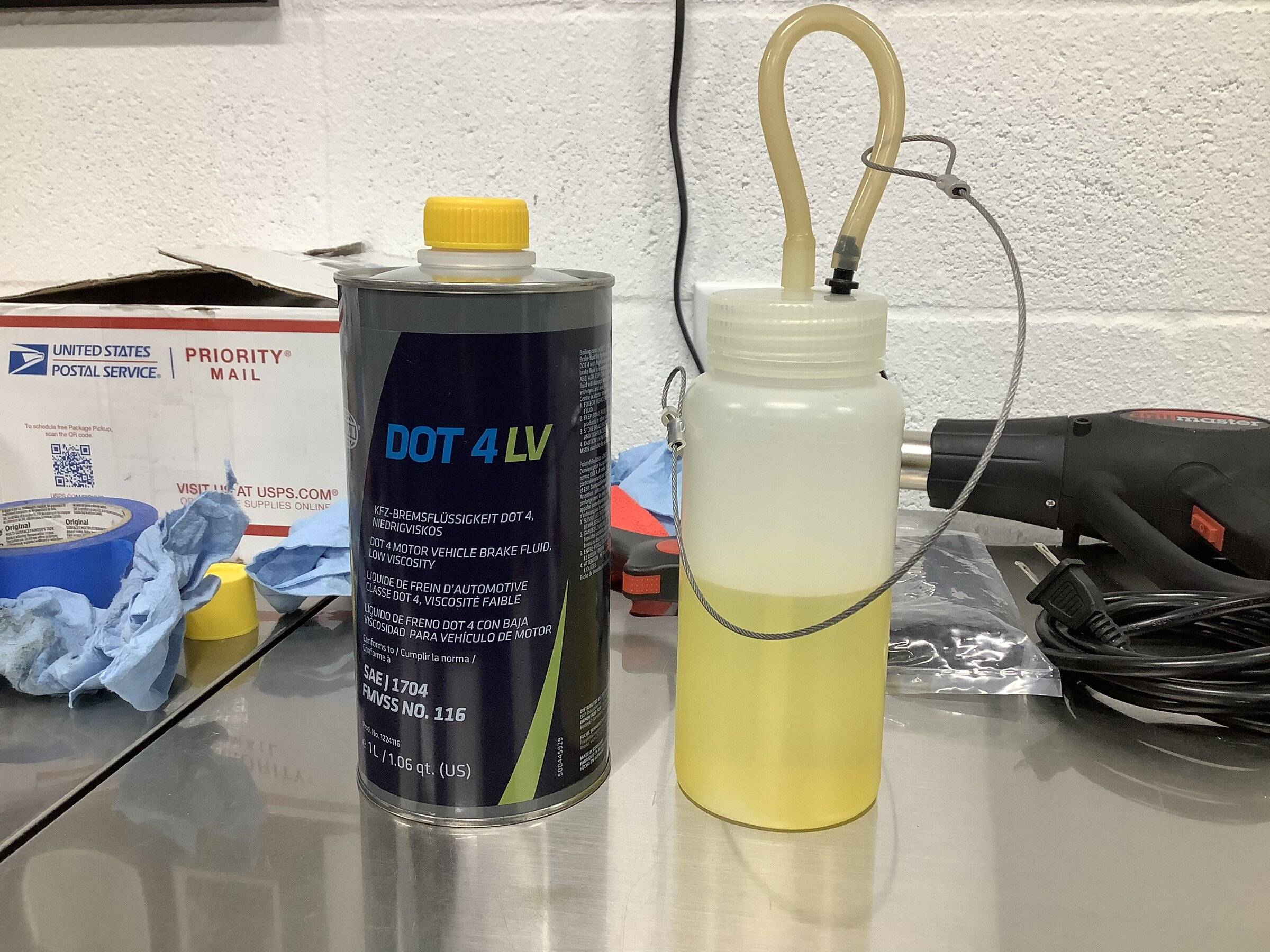

Update: Here are the start and stop videos of the 3rd bleeding procedure (2nd gravity bleed) that I’ve done on the clutch system. I started out with a new quart size bottle of DOT 4 LV brake fluid and I have used all but about 6oz of it. I am now 100% certain that I have more than adequately bled the system at this point. Having said that, the noise is still existent. I think I’m going to continue prepping the car to drive and test it out. It may just be that this new discovery has surfaced, now that I am running six new hydraulic lines totaling 199ā€œ as opposed to the single 36ā€ Steeda SS braided line that I recently removed to facilitate this mod. I’ll keep everyone posted as to how things shake out. Thank you all for your help and suggestions.
Brake fluid bleed bottle contents, post 2nd gravity bleed.

I just did the math and I’ve actually added a total of 163ā€ of clutch line (minus the fittings), so there has been considerably more hydraulic fluid added to the system. I am seriously wondering if the additional volume of fluid could be causing the amplified squeaking.
Why, added a total of 163/193 " ?
