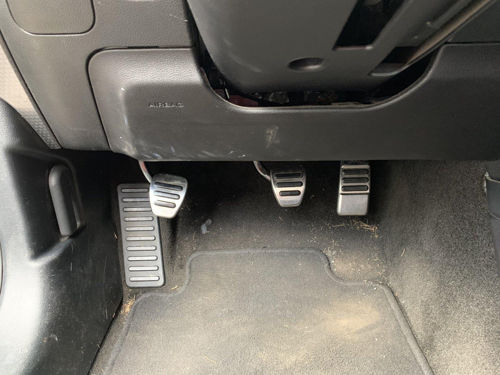

Hello all, I’m hoping someone can lend some knowledge.
My clutch pedal keeps pulling over to the left, out of alignment and making contact with another component in the clutch pedal assembly. This prevents me from pressing the pedal all the way to the floor which as you can imagine, is very unsafe.
The issue started today out of nowhere. I’m definitely not comfortable driving the car in it’s curreny state.
My question is this: What exactly keeps the clutch pedal aligned and centered? If someone is willing to be a good samaratin and check out their car, I would greatly appreciate it.
TLDR: clutch pedal aligned to the the left. Attempting to depress/disengage clutch is met with resistance.

Sorry. I should have been more clear. It is the entire pedal bar. This should help:

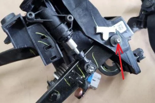

Thanks for the suggestion. I actually crawled under the dash and took a look. I didn’t see anything too out of whack, so I was hoping someone could figure out what keeps their pedal aligned.
The red arrow points to the clutch pedal metal pivot shaft. The plastic hole that it goes into probably broke and is causing the metal pivot shaft to move around.

^ What he said. :wink:
