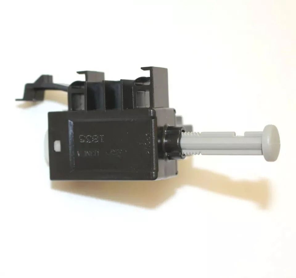

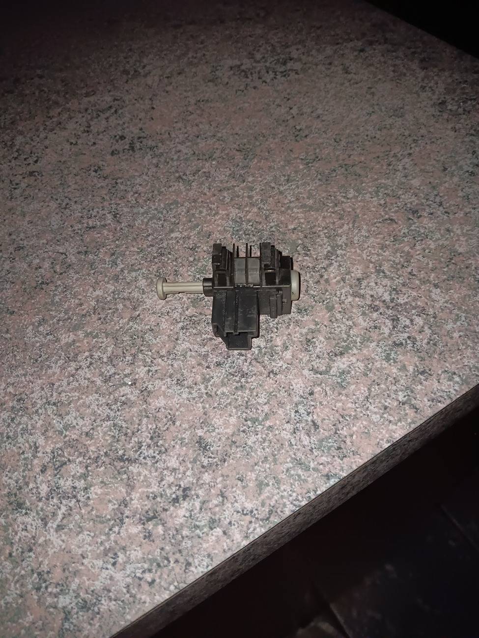

To update this, I think I have narrowed the issue down the the safety neutral switch keeps popping out of the bracket and interfering with the pedal movement.
When I look pictures of replacements online, I notice that mine is missing a tab. I remember finding some plastic in the floor board.
A replacement switch in on order. I'll update once installed.
Yeah, these break pretty easily. Blew mine apart taking the pedal assembly out and had to replace it.

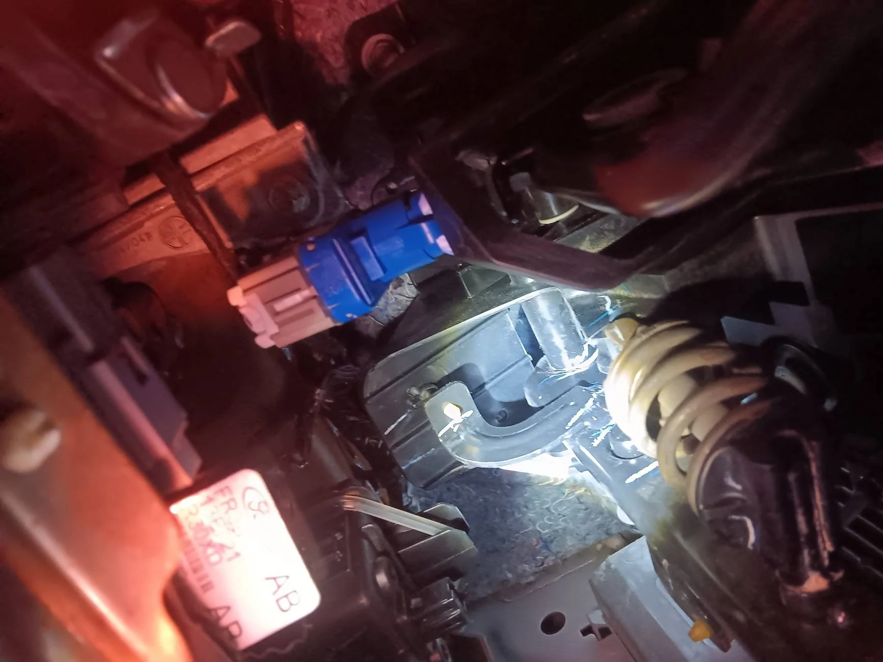

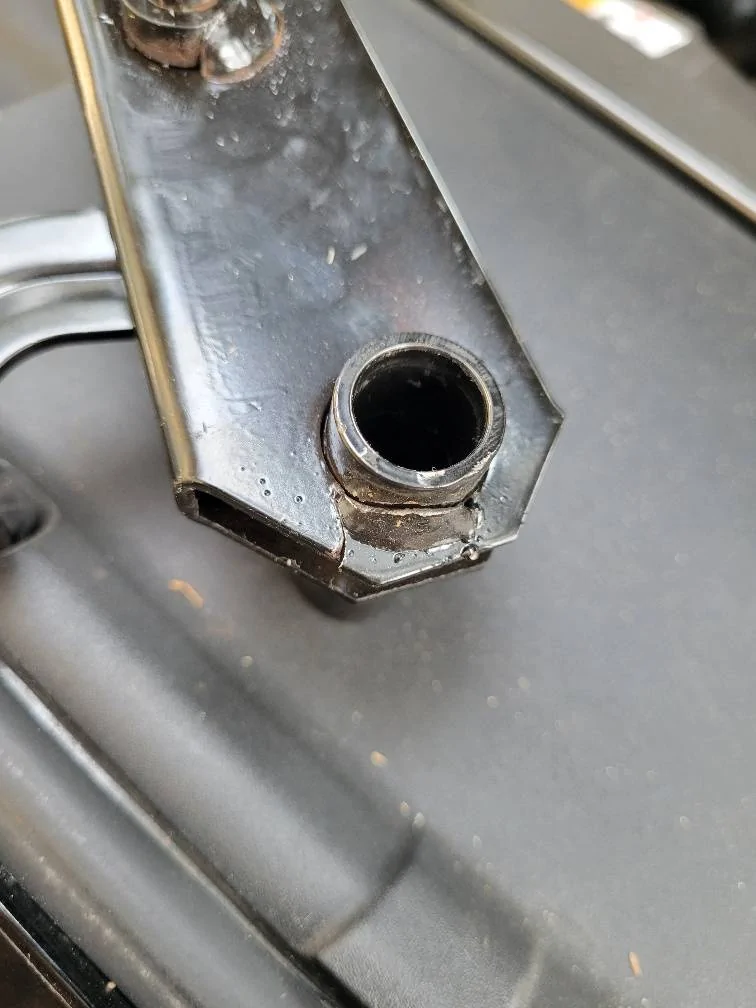

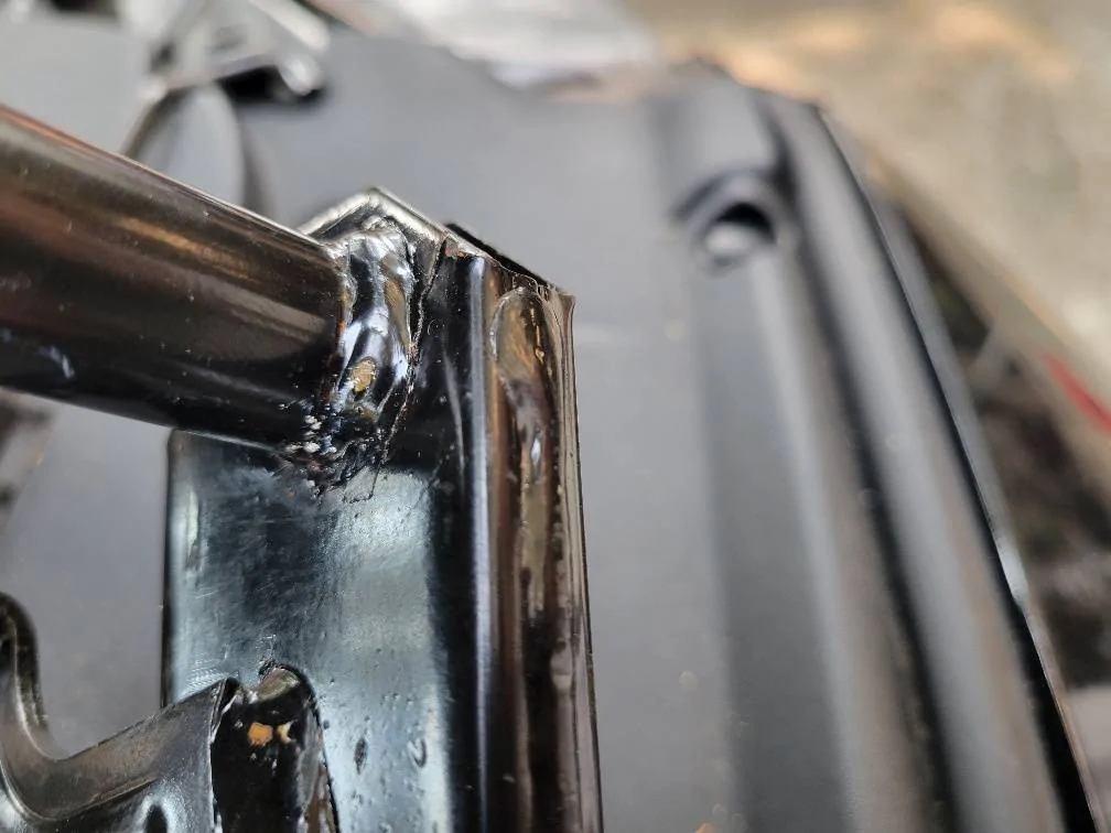

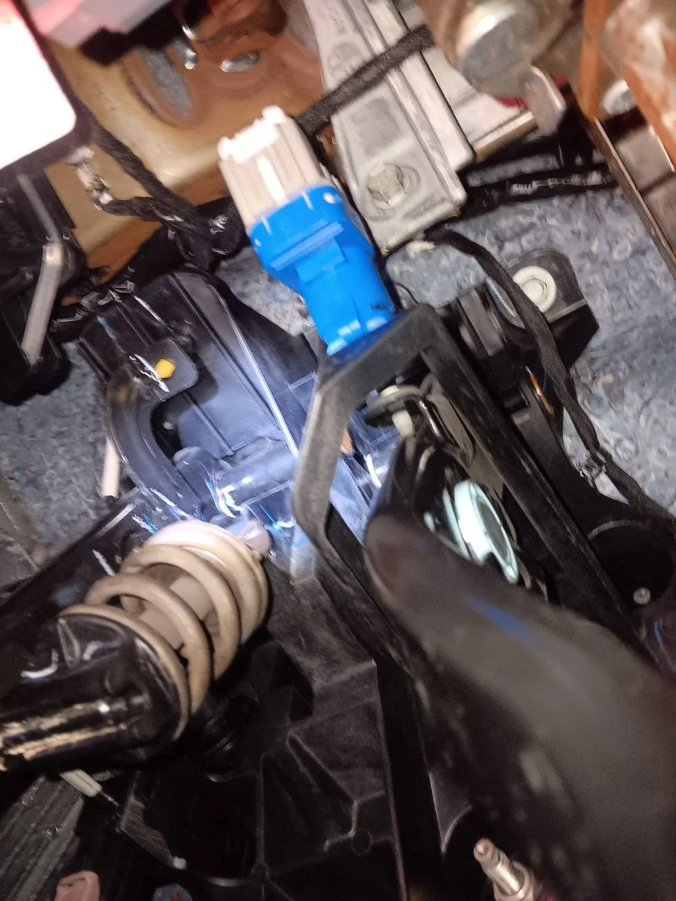

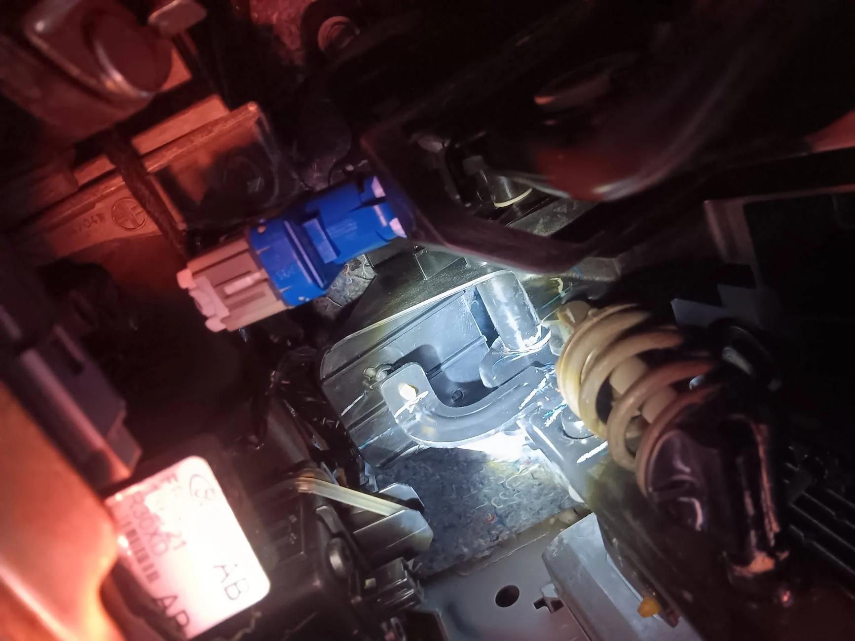

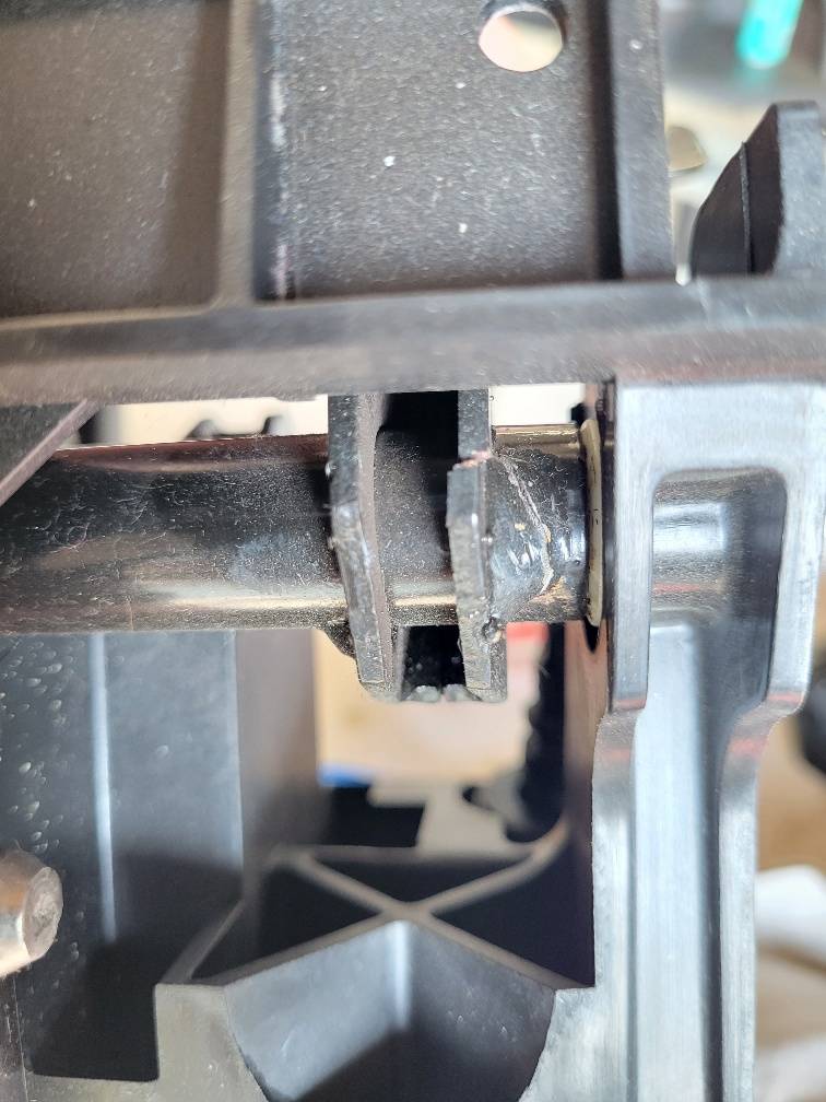

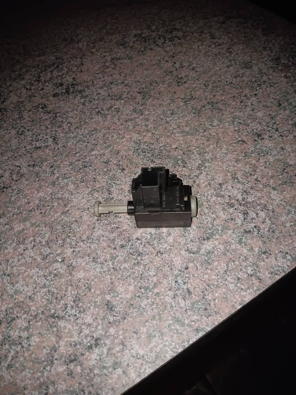

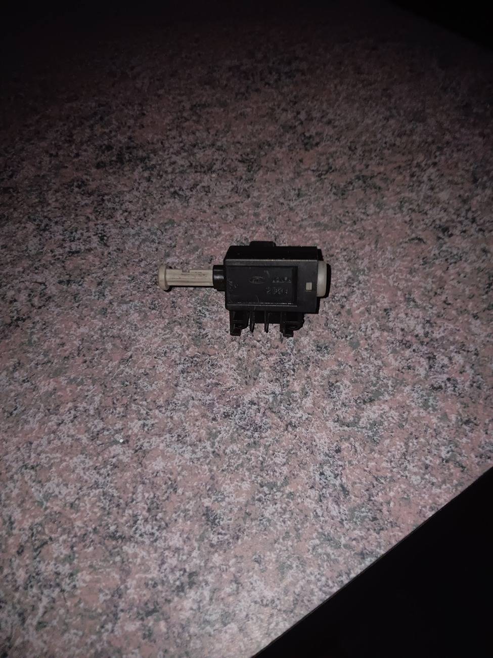

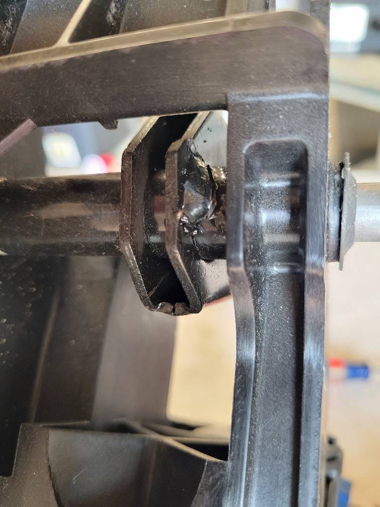

Well dammit. I put the new switch in and it seemed better for a little bit, but the issue came back.
Crawled under the dash this evening and was able to see a crack. Guess I'll be getting a workout and removing the assembly to re-weld.
Pics of the old switch and crack attached. (Crack is just above the spring)

I definitely feel your pain. I wonder if they are all prone to cracking?

This is a common issue. When I went through repairing mine, I took lot's of pics and filed a complaint with the NHTSA. Maybe if more of us do that it will force Ford to issue a recall.
Another thing to look at while you have the pedal assembly out is the slave hose connection at the brake master. These are known to become loose or were not properly connected at the factory.

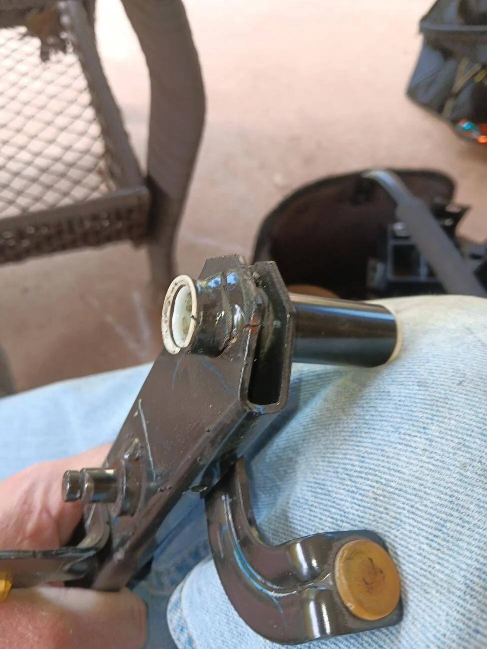

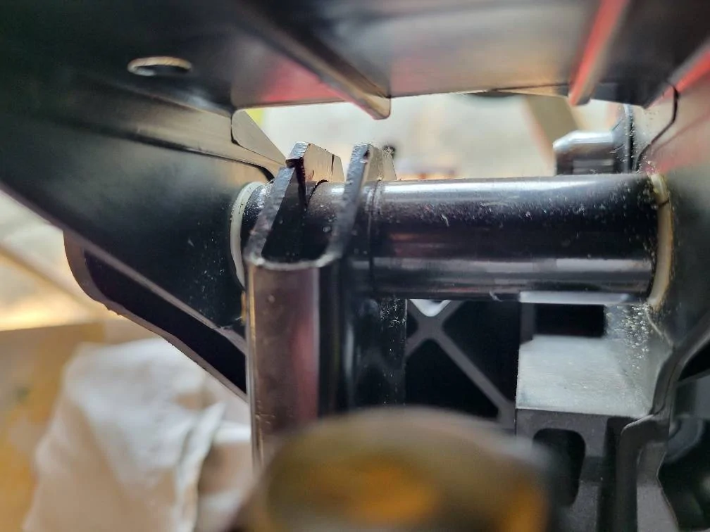

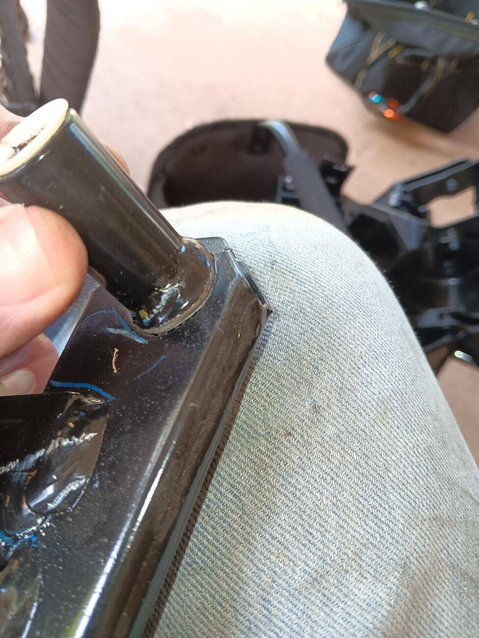

Well my back is still feeling the pain of getting the pedal assembly out. I got the clutch pedal re-welded and went ahead and did the brake pedal too. The factory welds were only about 40% around the shaft on both sides.
Today I'm gonna try to reinstall everything.
