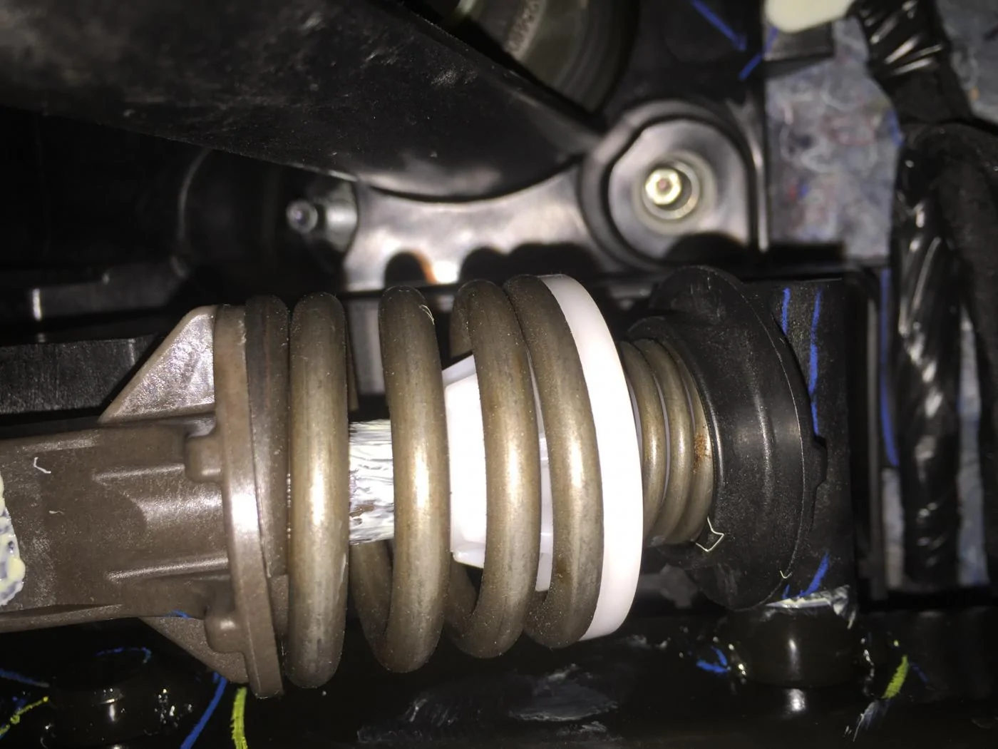

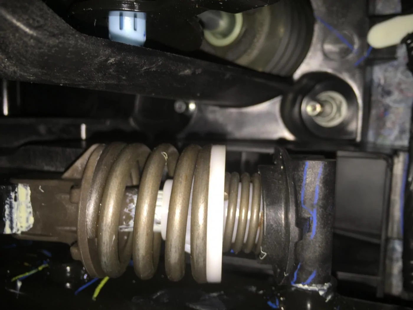

So...does anyone have a picture of the complete spring assembly out? I pulled mine out and it popped out into multiple pieces. Mine has more pieces the than the one in the video or pics in the post. There are actually two springs, a small and larger one. This is just in case I want to pop the thing back in. :headbonk:
After reading this tread I immediately ran out to my 13 and removed it post-haste... I wish I'd known about this sooner.... I will do it to the 350 next...
Here you go dude....
