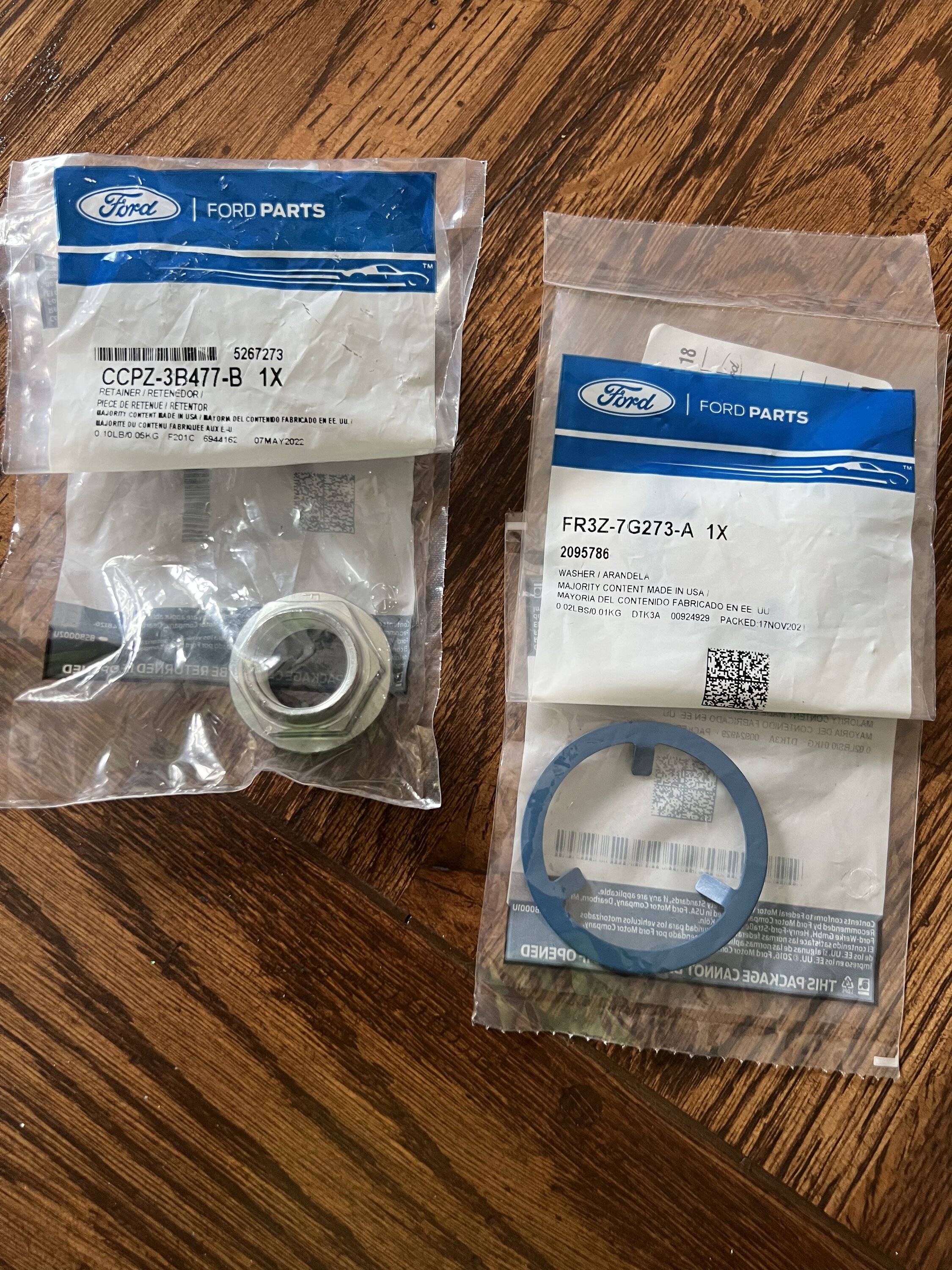

Just picked up new thrust washers /axle nuts.
Cobra Jet
Feb 12, 2015
771
17,601
20,049
Thanks for sharing the images with part #’s and visual of parts. The rear axle nuts and the thrust washers are common issues with some S550’s, so it will help those in the future looking for the parts.
I don't think thats the most recent thrust washer, should do the trick for now, but won't last as long as the newest version IMO.
MyStang
Dec 30, 2015
50
596
938
Michigan
2015 GT
DG9Z-7G273-B
Was for an Edge /Flex. The one I received is thicker than the one I am replacing. Ford parts department said it was the direct replacement part.
Old part size 0.021
New part size 0.051
