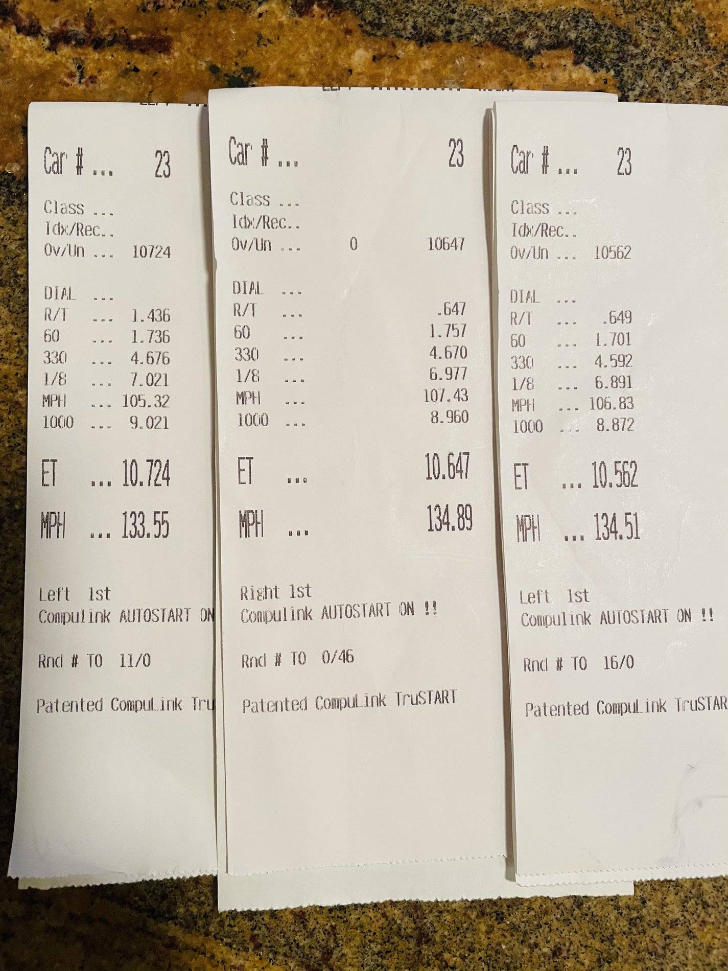

Need help deciding. Circle D offers their 258 mm NA converter in 4000-4400 stall and 4400-4600 stall. I understand the 4400-4600 is a new offering. Car is a daily with a 1 mile commute and is also used for short trip errands. It gets driven to track.

:shock:Go big. Imagine how close you’ll be to a 9 second slip with a 1.4 sixty.:wink:
