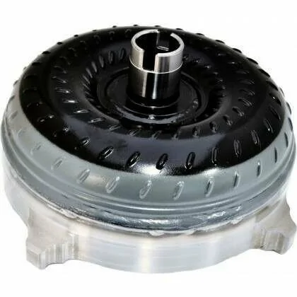

Anyone daily drive a whipple with a circle D converter? I was wondering how is it for a Daily. Ill be rebuilding the trans and thinking about upgrading the converter while I am at it.. The car is 99% a daily car and 1% track.

I have on one a vortech, works fine on the street.

Circle D 2C with TVS. You don't even know it's there.

I have a Whipple and a Circle D - The car originally had a 245mm 4C when it was NA and I liked it a lot, but you could definitely tell it had a loose converter in it. Once I put the Whipple on and got it out to the track, I sent Circle D the data logs and they convinced me the car needed a 252mm 2C (I think that's right). That slowed the car down, both 60ft and quarter mile.
I discussed this with them and ended up sending them the original 245mm converter which they 'tweaked' for my setup, and I'm happy with the results. On 15psi the car has gone a best of 9.92 at 139mph and a best 60ft of 1.400. On the street, which is 99% of the time (with 10psi), it's still obvious it's got a loose converter, but it drives just fine.

I was running the pump gas tune when I went through the converter changes, so it was a little different. I remember the 60ft went from 1.43 to 1.45, and I lost about a tenth and some mph on the big end when I put the 252mm converter in. That was in Vegas a year ago at the SCSN, and the car was running 10.6x on pump gas at 132mph.

Circle D is very conservative when it comes to 6r converters. If you want performance, looser is better than tighter and you have to tell them max performance is top priority.

I wanted to do the swap myself but CircleD said the canned tune would not work
and that seems to go in line with what im hearing . My regret is not getting a manual lol

I drove Project Goldmember with a Circle D converter and 19psi on a Whipple Gen 5 3.0L without any issues on the street. The car drove great. Amazing that you can go 8's in a car like that and drive it around on the street like it's a stock vehicle.
