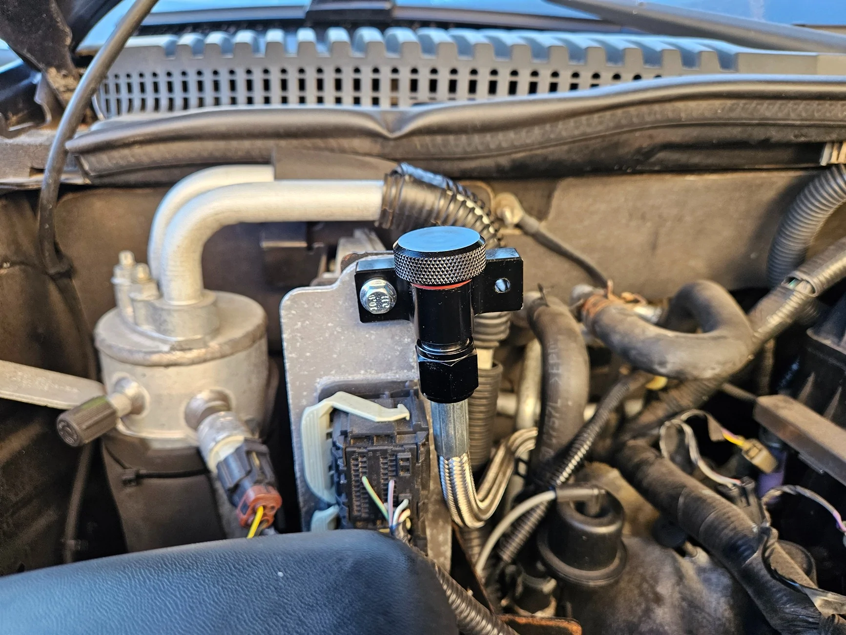

Checking a 10R80 trans fluid level.

I bought 3 of them, first one went into my 2010 explorer with the 4.6 3v and a 6R80, I paid 70 for it from LMR.
I then looked on amazon and found the exact same thing for 38 so I put another one in my mach 1 with the 10R80. I bought a 3rd one for my 23 explorer ST with a 10R60 but haven't installed it yet.

Now I have to see if I can get the stock filler cap to break free... Tried to once and couldn't get it off.

put the box end of a 19mm on it and hook another wrench on the open end and double the leverage. Or if you have room, smack the wrench with a hammer.

You will laugh when I tell you my story about getting that filler cap off for the first time. About 2 years ago I decided to change the transmission filter, this was at about 40K miles. Now I have more tools than 95% of the people on this planet but I could not get a socket, box end or open ended wrench on that cap that allowed me enough space to break it free. I believe the cap is made of cheap aluminum and after almost stripping it, from not being able to get a good bite on it, I lost my mind; this was about 2 hours into the process. I then ripped up the carpet on the passengers side and drilled a hole above the cap so I could get a socket through the floorboard and onto it. That worked fine and it make it easy to refill from the top. Now I just tighten the cap snugly and an open ended wrench is able to get a good enough bite on it to get it off. I'm somewhat embarrassed at my solution but extreme problems require extreme solutions.

Did you find the right size rubber plug to finish off the hole you drilled? I like the Idea, I think you have the solution to checking it hot as well!

When I got done the hole was pretty ugly and not exactly round, I should have put a metal plate over it for future access but I patched it with some fiberglass cloth and epoxy resin. My biggest mistake was not buying a metal trans pan, to replace the plastic one, with a drain plug in it when I had the plastic one off.

I like the idea of buying the dipstick you installed but when I look on Amazon it says it is for a truck. I assume it works OK with your car since you have it installed. Do you find that it a high enough quality to withstand the heat it will get from the catalytic converter right next to it? Is the little dipstick on the end long enough to go into the transmission and give you pretty good readings?
