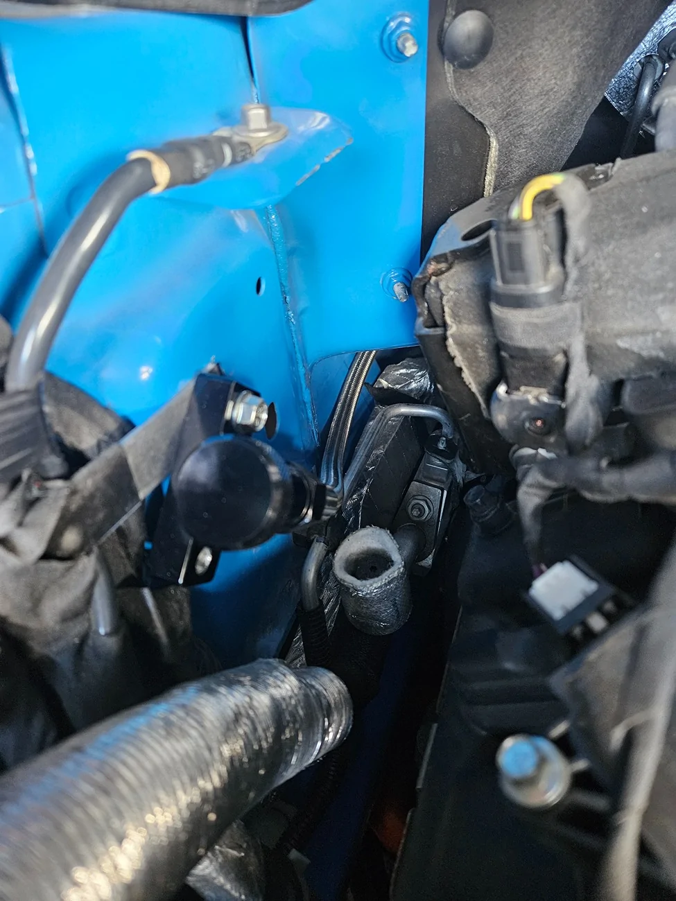

I Bleed Ford Blue
Nov 24, 2018
50
2,664
3,180
North East OHIO
Just buy a real transmission dipstick, 37 bucks on Amazon. https://www.amazon.com/dp/B0F6MYWGLG?ref=ppx_yo2ov_dt_b_fed_asin_title
Just line up the new one with the little stubby dipstick and use a file to mark where the full mark should be. I was able to bolt it to an existing hole in the passenger shock tower, I just had to find a longer 6mm bolt and open up the holes on the top bracket to 1/4" to clear the 6mm bolt.
