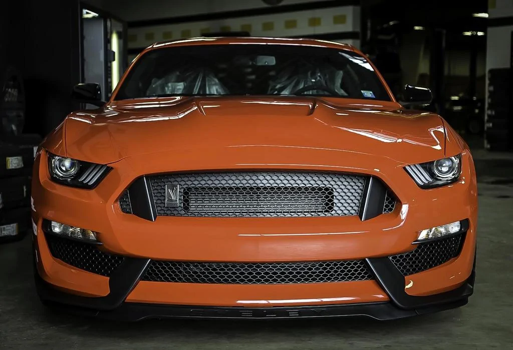

That's a good point. If the wings aren't as far back as they can go it looks like it might affect the center piece installation since it overlaps the wings, which in turn might affect that center tab. I like ThreeFiveO's suggestion that I retain my sanity until such time as it might be an issue. If the center piece ever comes out of that center tab and I have to readjust again I'll reinstall the wings and half-moon clips as well.
For those of you who are thinking about doing this, I found the advice to use paper (Video dude uses paper and so did I) or tape to hold the 45 degree screws in the socket very useful.
This is the pic of the car over on another web site (my first post was mistaken) that I saw a week or so ago. It seems to be a common issue on dealer installed splitters.
