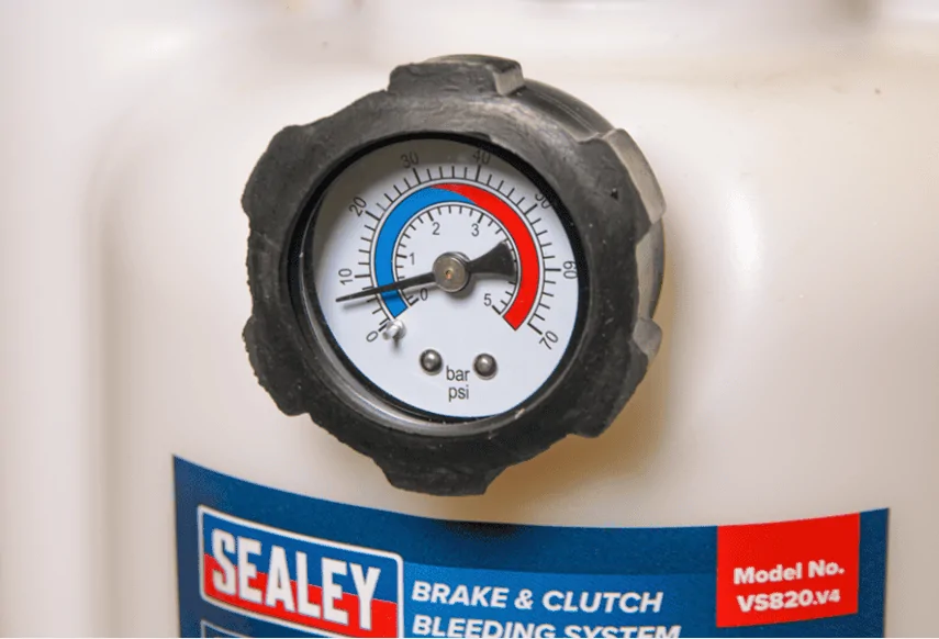

I've just noticed something.

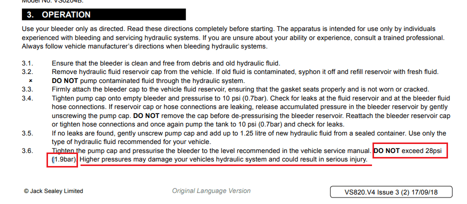

The instructions for my pressure bleeder state that I should not exceed 28 psi.
On the pressure indicator the red zone starts at 32 psi.

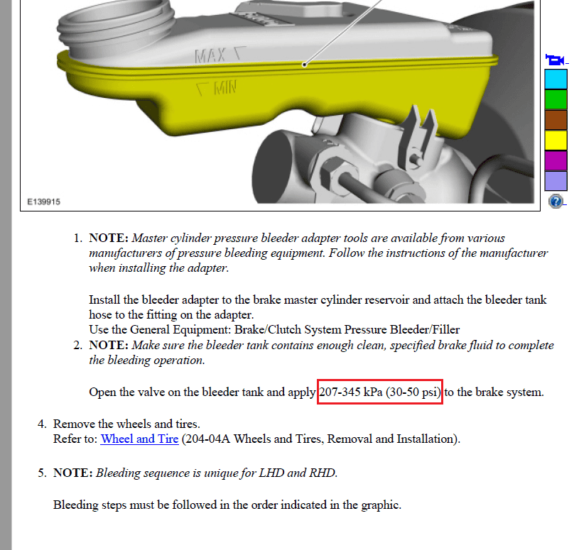

However, here's what the service manual says:
Why do they recommend such a high pressure? 20 psi worked just fine for me.
Does this have to do with the valves in the ABS module? Do you need higher pressures to open them up?
A few thoughts.
28 psi seems oddly specific.
They say not to exceed 28 psi out of concern for the vehicle, not the tool.
Cheaper to buy a guage off the shelf than have a special one made.
Ford says 30-50 psi, if they tell their service people it can go to 50 psi it probably has.
Seems to me the factory service manual should be the authority, not a random tool manufacturer.
If 20 psi worked for you, great. 5 or 10 would have worked too.
30+ would have been faster

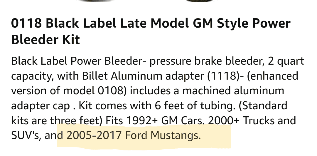

I've only done the two person method, but I want to make my life easier, so this time around I'm going to get the Motive kit. Just want to confirm which one fits 15-17 PP GTs. I've read and watched videos with guys using the 0109 kit on GT350s and it fit. But, it actually says it's for European vehicles. The 0118 kit however actually says it's for Ford Mustangs 05-2017. Can anyone confirm which one to buy?
Motive Kit 0109
https://www.amazon.com/gp/aw/d/B000Q6SL2W/ref=ox_sc_saved_image_1?smid=A2IS69AN9A0OWP&psc=1
Or
Motive Kit 0118
https://www.amazon.com/gp/aw/d/B00942X5EI/ref=ox_sc_saved_image_4?smid=A2IS69AN9A0sc=1

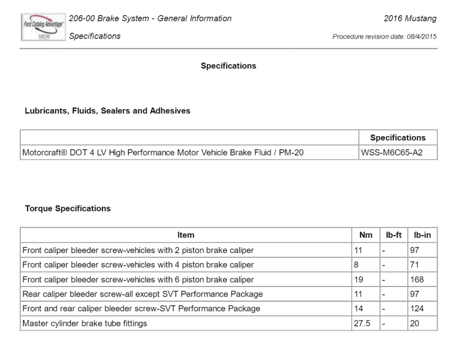

This thread has been a very informative read. I would just like to comment on the recommended torque for the bleeder plugs.
I have methods that allow me not to have to obsess over fastener torque, but in the case of the bleed screws, DO use a 1/4" torque wrench to tighten the nipples to ~50 inch-pounds. You want a tight seal, but over tightening can damage the caliper seats which will then cause a leak.
There is a thread about this on M6G forum for GT350 here:
https://www.mustang6g.com/forums/threads/torque-values-for-caliper-bleed-screws.179044/
I was searching for the same info for Mach 1 and eventually found out that the torque depends on several factors (type of calipers, size of the bleeder plug). Here is an excerpt from original 2015 Mustang technical spec.
Another recommendation for Brembo calipers (from Brembo):
https://www.bremboparts.com/europe/...ctions-for-replacing-the-brake-caliper-280503
Bleeder plugM6x1M8x1,25M10x1M12x1
Tightening torque5Ă·7 Nm7Ă·10 Nm17Ă·20 Nm18Ă·22 Nm
I have yet to verify the exact size of the bleeder plug on Mach 1, but complementing both info, it seems 19 Nm (168 lb-in) looks like the right candidate.
