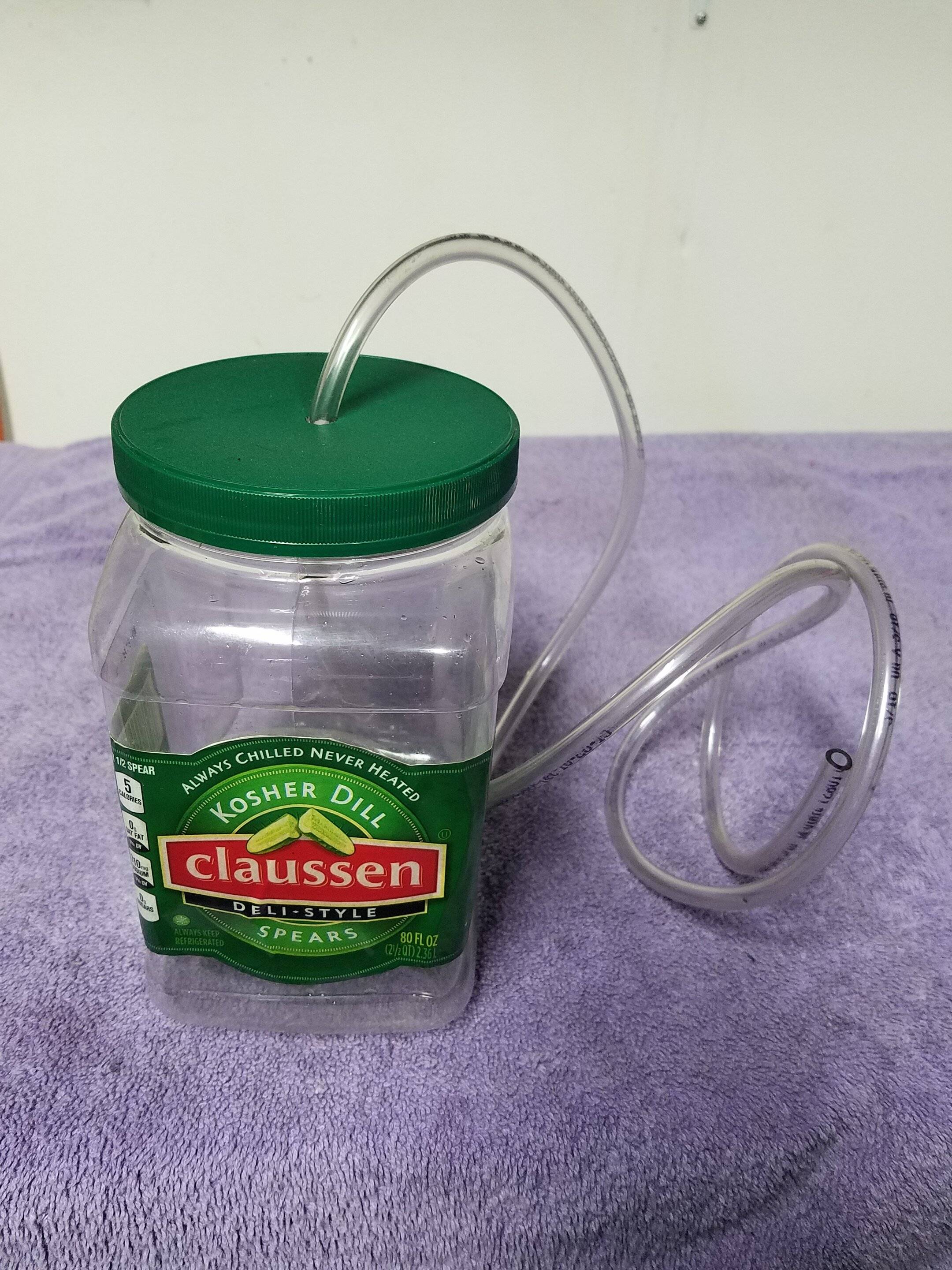

I went DIY with 5/16" hole drilled into top of pickle jar. Works great.
You'll want 3ft of 3/16 ID tubing.
