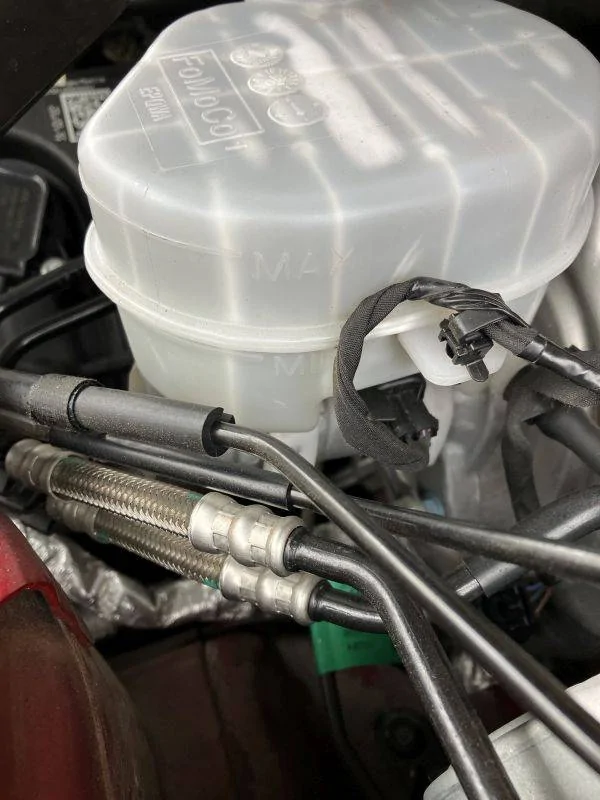

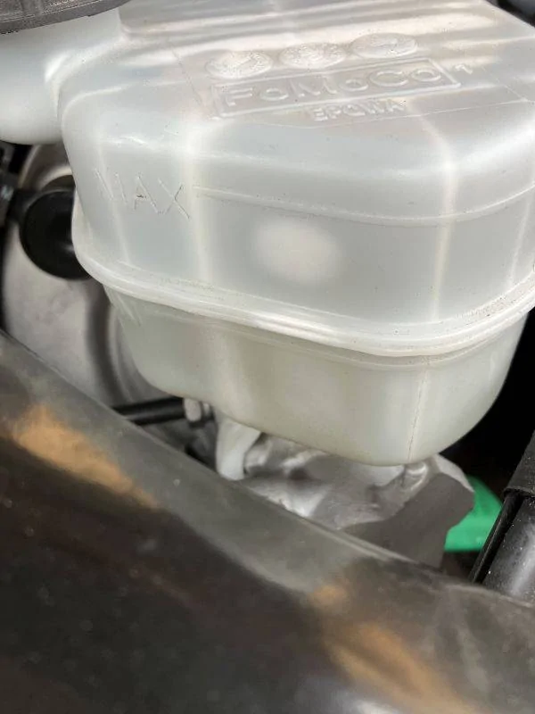

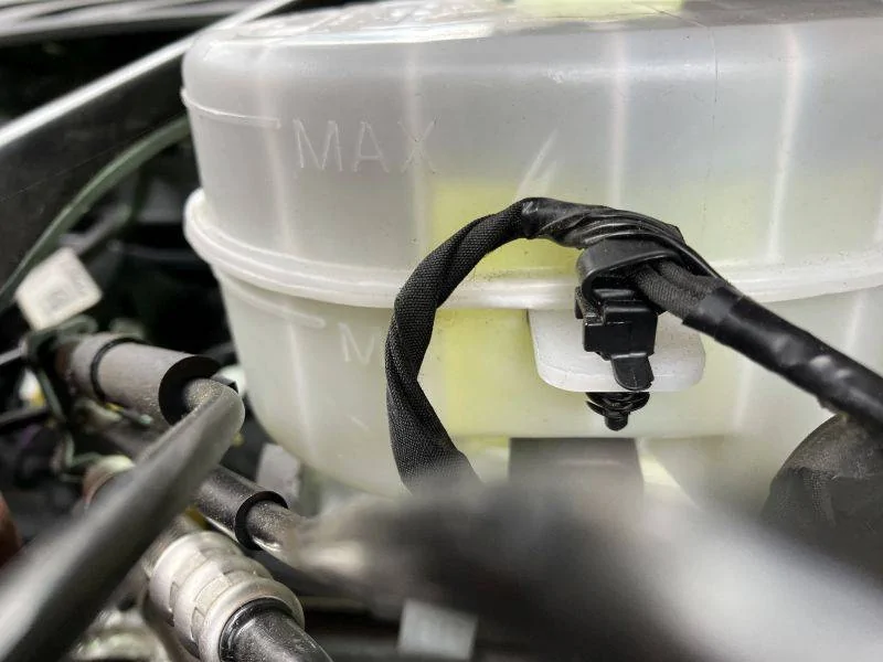

Most of you are probably aware of this trick, but I wasn't, and I discovered it myself after quite a lot of head scratching and swearing. How are you supposed to check the fluid level in an opaque container?
No idea where the actual level is. The reservoir could very well be empty.
Removing the cap and looking down the filling neck doesn't help either, because the only thing you can see in there is just a small hole, not the actual space where the bulk of the fluid is.
In the end I tried to shine a flashlight through the side of the reservoir opposite to where I was looking, and voilĆ”! A portion of the right hand side wall is slightly more transparent than the rest (which otherwise you wouldn't have noticed), and the brake fluid can now be clearly seen.
I only learned this trick after 100s of brake bleeds lol and it was by accident. my helper had a flashlight and sat it on the reservoir. Shining the light from the top pointed down allowed me to see the fluid level clear as day.
