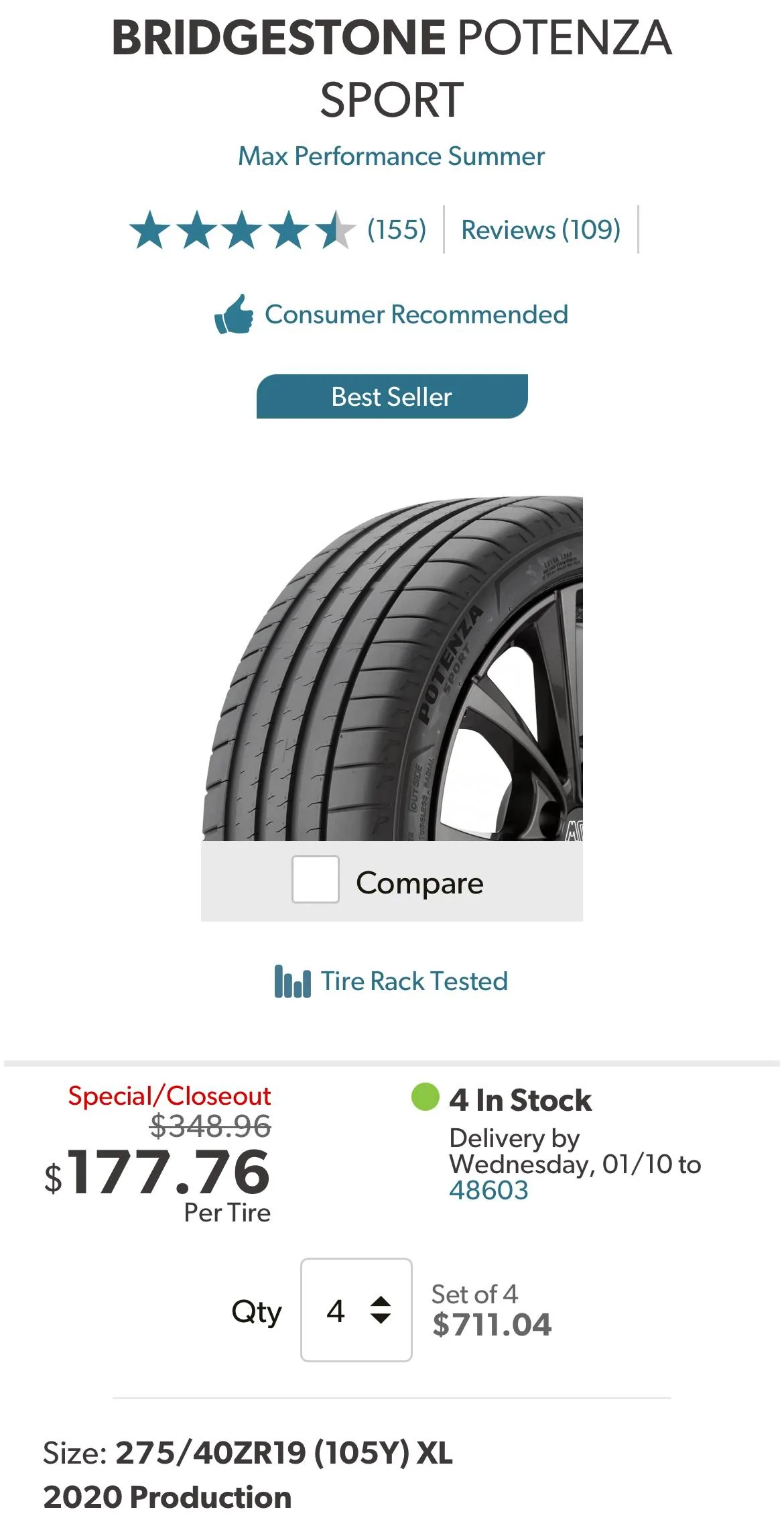

Would you want to fit a 275 on your existing wheel?
maybe buy a set of 19x9.5" cheap online (under $900)
then buy some closeout tires on tire rack
sells your stock wheels/tires
